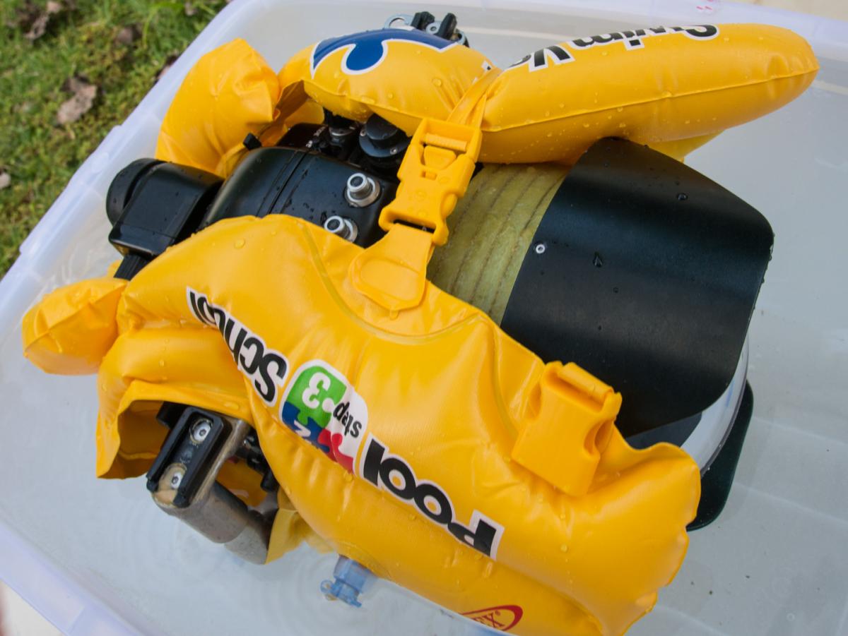

  5. This kid's lifejacket can work to support a housing for over/under shots.
