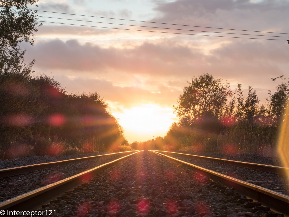

    1. Lens internal reflections are aggravated and take a grid shape where the AF pixels are located
    2. In certain situations you have PDAF striping where you can see stripes in the frame aligned with the AF pixels
    3. In other cases of low light you also have banding
    In essence the AF create patterns and increase fixed pattern noise this generates banding artefacts and more

  2. Could you show a few examples?
    They are not underwater shots don't have a housing for the Olympus
    There are many examples around just google Sony PDAF Striping or banding

  9. Coincidentally, I took a very similar shot of the setting sun on Saturday with my EM-1 mk II.  These were test shots as I was setting up for sunset.  I can see no evidence of striping or banding in the first JPG or when pixel-peeping the RAW file, though the highlights are certainly blown which explains the flare on the black coastline at the left.  The bright specs that might suggest evidence are actually whitecaps, it was a windy evening.  The second JPG shows a very uniform black silhouette.
    I don't think I have ever seen evidence of striping or banding from points of light above ground or underwater, even when lifting shadows further than they should be.  I'd be curious to hear what specific combination of factors seem to aggravate this newly discovered issue.
  10. Is it possible that some of the more extreme examples are lens-dependent?    Olympus cameras have a different UV cut-off on the sensor filter, which leads to issues like purple blobs from the Panasonic 7-14.  There's also an issue with banding from the P20 1.7, but I believe that has a separate root cause than the filter...
    Normally you will see ghosting and lens flare more or less controlled. You also have ghosting which your image is an example of.
    However if you close the aperture to say f/11 and smaller which you do with a sunburst you see some red dots appearing this issue does not occur at wide apertures.
    Why does it happen? Is a combination of lens flare AND bouncing on the UV coating of the sensor that is made of highly reflective material. The AF pixels make this more apparent  however if you push really hard you may see some artefacts on contrast detection too. I have not yet been able to recreate the issue on my Panasonic cameras but I have seen it demonstrated on Olympus cameras with contrast detection.
    Note this issue applies also to Fuji, Sony APSC for what I know. I have not seen examples on full frame mirrorless however those have other issues

    Hi Massimo,
    Your picture looks interesting. I did never observe such a dot pattern in my images from EM1II. I believe your exposure conditions must have been special. Could you please specify the EXIF data, lens and how you postprocessed?
    I count (roughly) 9*8= 72 of the dots, but the EM1II sensor has 121 PDAF pixels. How do these numbers correlate and how do the dots correlate with the location of PDAF pixels?
    Wolfgang

  16. 3 hours ago, Architeuthis said:
    Hi Massimo,
    Wolfgang
    Nothing special is f/13 the issue starts appearing from around f/8 wider you only see a bit of lens flare
    You don't see all the AF pixels reflected in the lens depending on the incident angle where the lens flare came from
    Look closer at your sunburst f/9 posted on dpreview https://www.dpreview.com/forums/post/64485695?image=5
    I can see few artefacts there. If you push that to f/11 and smaller the bubble may indeed appear

    The issue in my image is number 3 sensor reflections (of AF pixels) this is not the same as banding or striping and occurs in a specific scenario with all cameras. PDAF pixels only aggravate it
