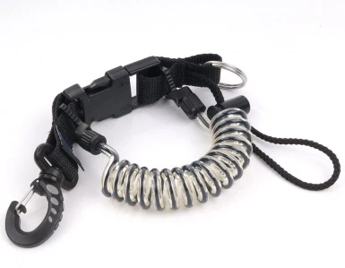

    I shore dive regularly getting in and out where both hands are needed due to swell etc.  I put a coiled lanyard (images are above) on one side and on the other have a carabiner/double ended bolt snap then a stainless snap shackle which is quick release.  Coil lanyard goes to top right shoulder d-ring and the other stuff to the left shoulder lower d-ring.  Camera hangs level and frees both hands.  Hook it all back up before getting out.  The quick release comes into play boat diving as it allows me to unhook the coiled lanyard and release the other side just before handing the camera up.   I find it a good system.
    I also have a short lanyard connecting the top of the two strobe arms.  I use long clamps with shackles for that joint.  The lanyard can stay there for macro work, if I need to spread arms remove one end and clip both ends to same side, or remove all together and clip to a d-ring.

    Hi George didn't post a pic - sorry, I posted about one on another thread recently.  One like this:  Oceanic-Coiled-Lanyard__61438.1539914768
    There's various flavours and combos of clips and type of coiled cable available but it allows you to clip up so you can shorten it  for use getting in and out of the water when you go hands free.  I find them very effective.
