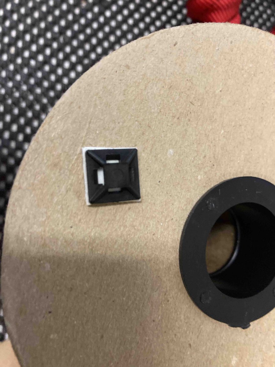

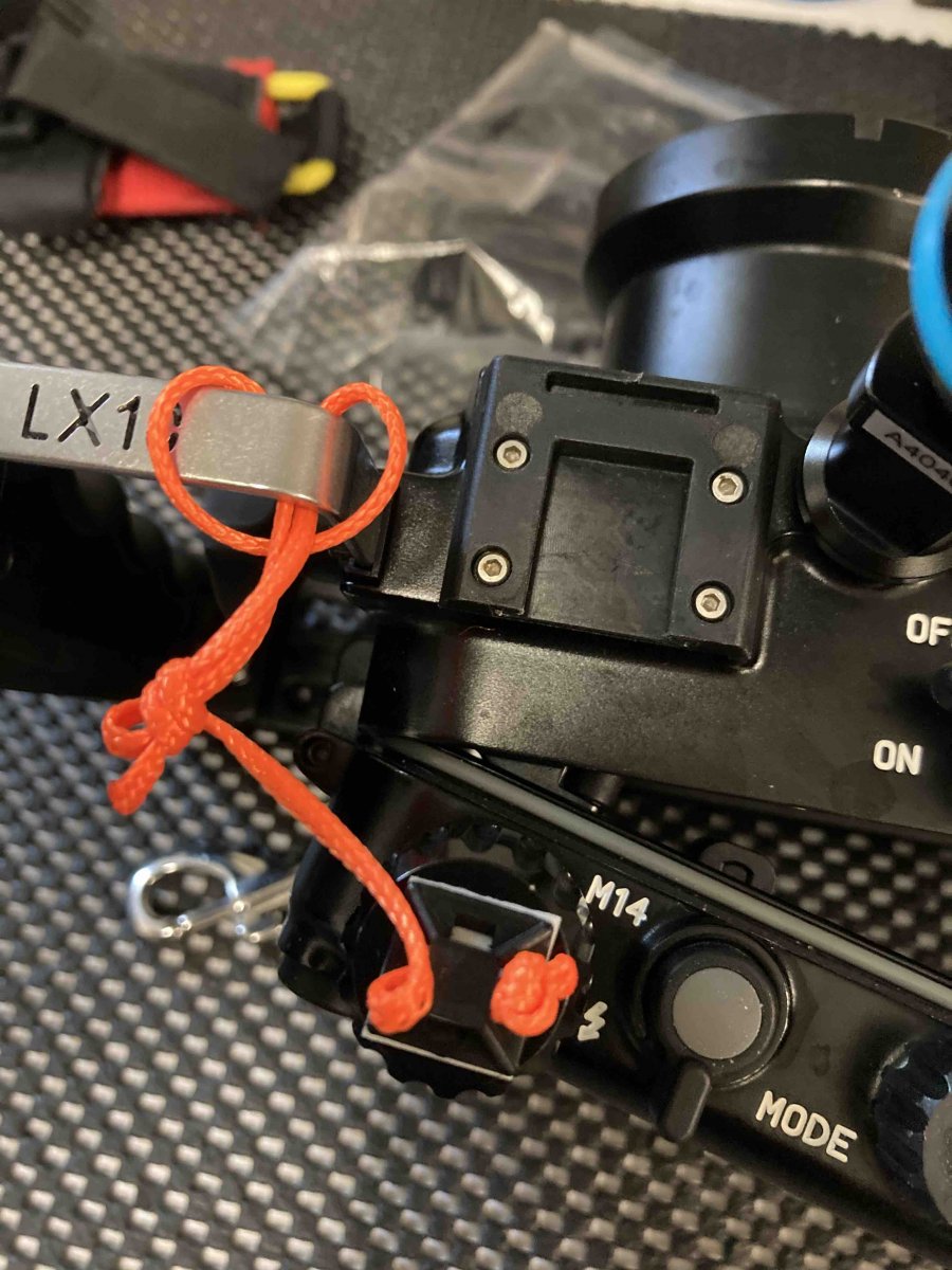

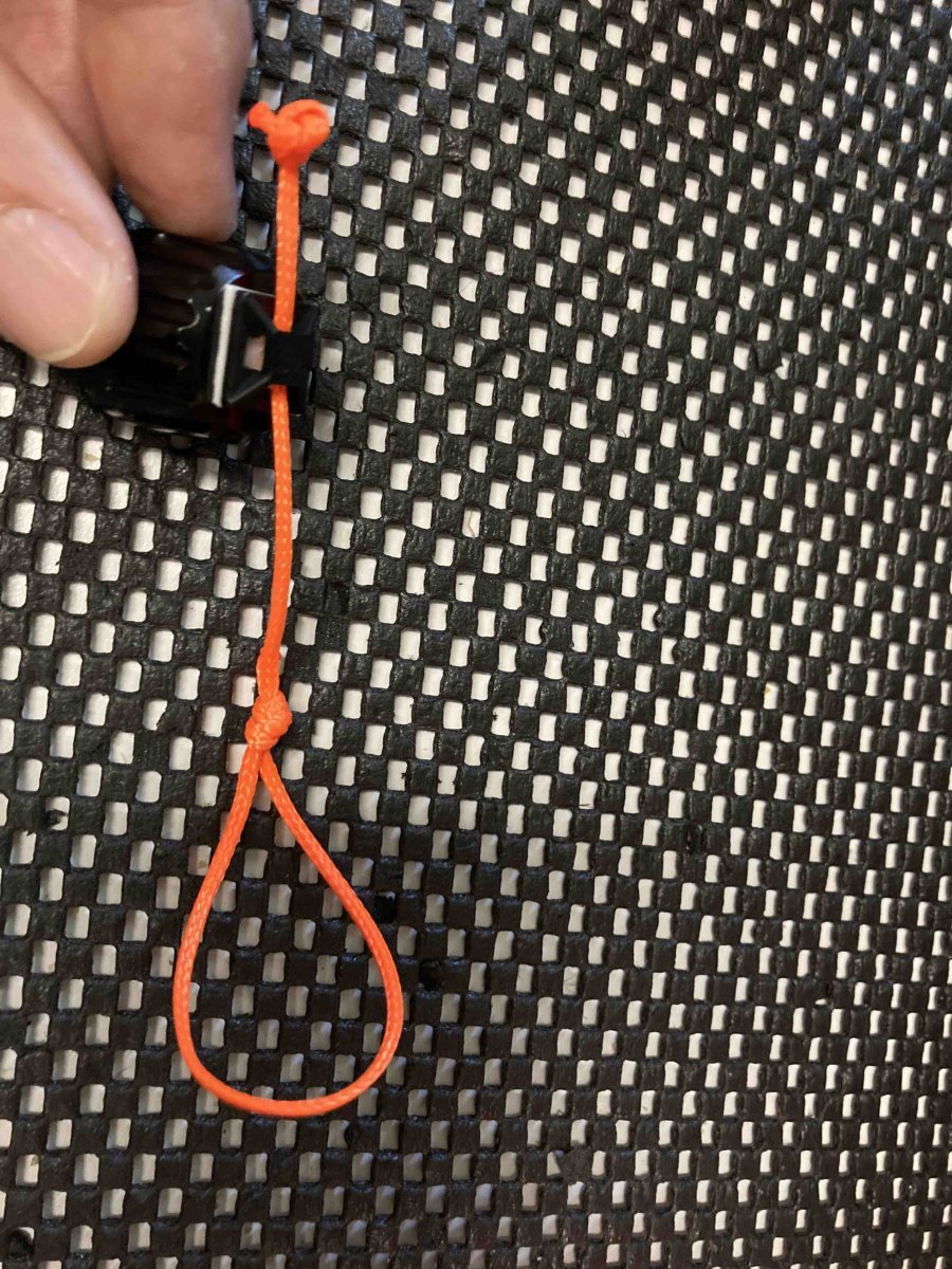

  4. I "lost" my cap for a few days and then ended up finding it. After that scare, I bought some little square stickers from Amazon and did the following:
  5. That's smart! could you share the amazon link? What did you stick on it?
  6. Thanks! I've used them for quite a few things, actually.
    Below is a link to what I bought. The hardest part was just trying to figure out what to search for. :)
    https://www.amazon.com/gp/product/B083416L5L/ref=ppx_yo_dt_b_asin_title_o05_s00?ie=UTF8&psc=1
    I'm not sure what you mean by "What did you stick on it?" The zip tie "anchors" that I bought have stickers "built in" on them so I just put it on the vacuum cover and then tied cave line to it.
    Let me know if you want more info or pictures.
    - brett
