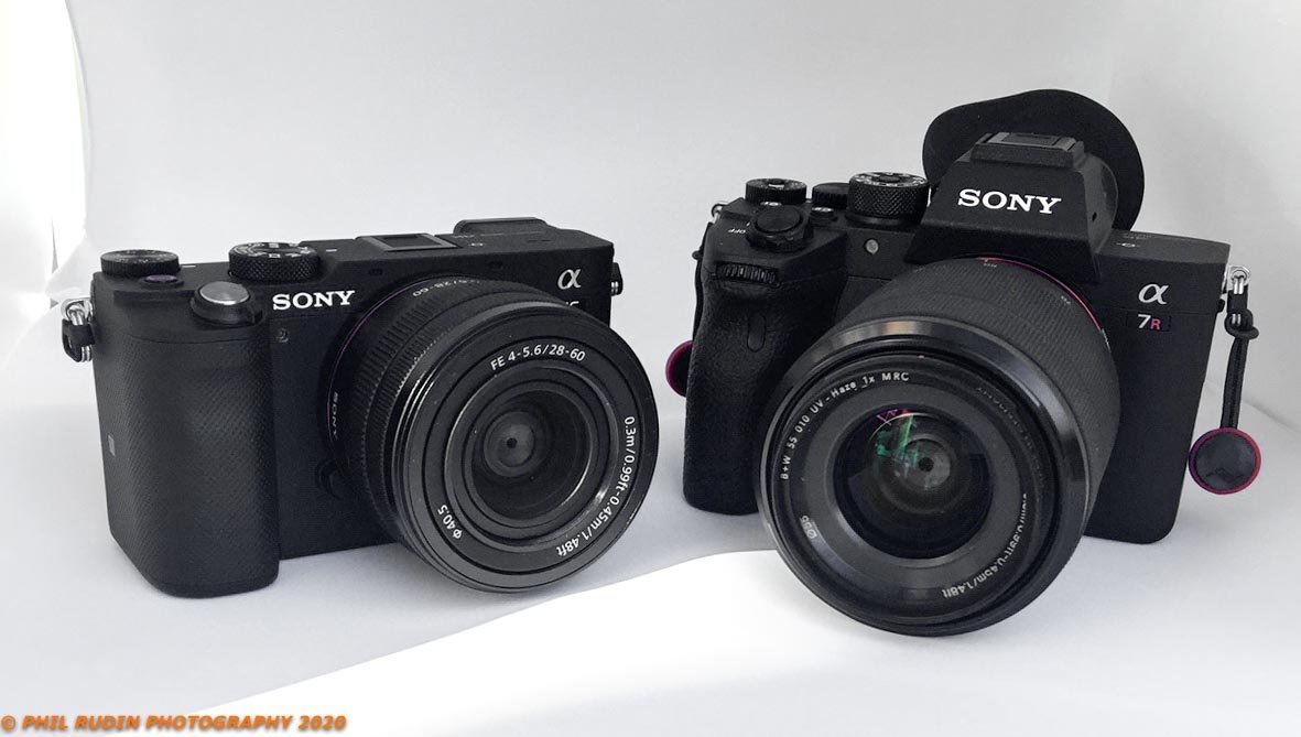

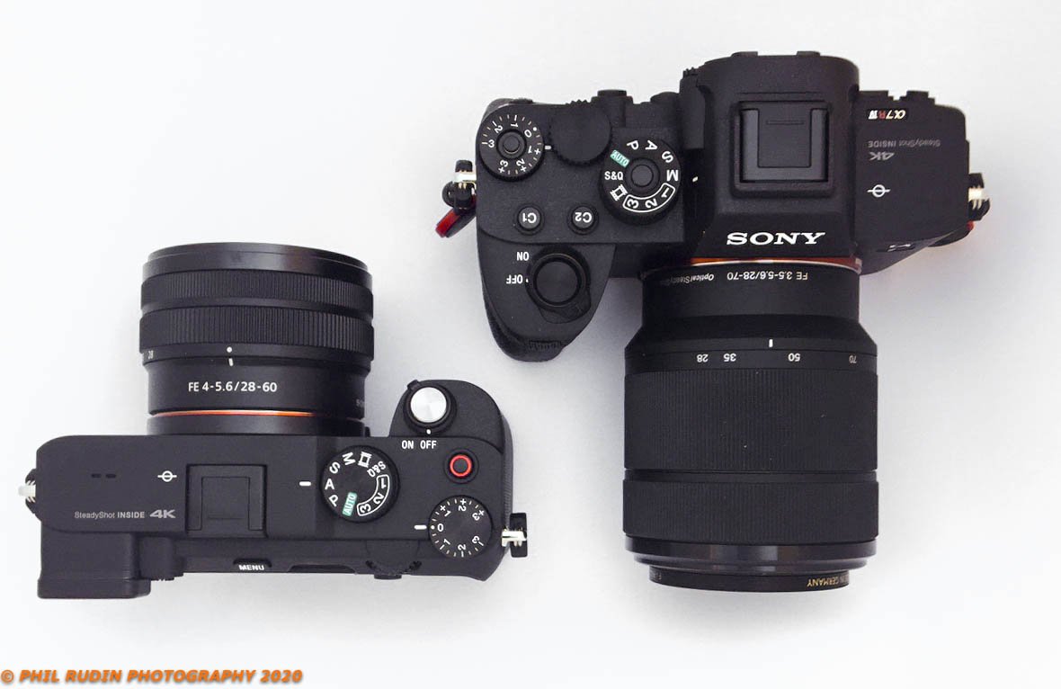

  9. Most Photographers moving to full frame are looking for more flexibility between noise and resolution, improved dynamic range, equivalent focal length I.E. no crop factor, better DOF on the shallow end and an assumption that "Pro" bodies will have more pro features like better AF speed, better tracking, weather sealing and much more.
    I think it is safe to assume that most photographers buying into a new system are looking for smaller and lighter equipment. This extends beyond the issue of mounting travel restrictions and includes an aging photographer population, ease of use and competition from cell phone systems and action cams like Gopro.
    I would guess that most photographers when talking about FF assume much greater numbers of megapixels than M4/3 or APS-C camera versions. The issues for moving to full frame apply to the many FF cameras in the market now that are not considered high res as well. Canon ESO R6, Nikon Z6 II and Sony A7 III are all cameras in the 20-24MP range that all provide better image quality for the above reasons than the best M4/3 and APS-C cameras and they all sell for under $2500.00US or so.
    My point here is that at least in the mirrorless world full frame is becoming very affordable V. M4/3 & APS-C.
    Sony has just released the A7C 24.2MP full frame camera with a 28-60mm F/4-5.6 FF lens in a kit for $2098.00US retail. I am pointing out this camera because it has all of the upsides of FF including the latest Sony AF and tracking speed  with eye detect in a package the size of the APS-C A6600 which sells for $1800.00US with a kit lens. The 28-60mm Kit lens is reported to have much better image quality than the aging Sony 28-70mm F3.5-5.6 and it is about half the size and weight.
    Yesterday Nauticam added the FE 28-60mm lens to its Sony port chart and Sony owners should be excited. First the lens works with all Sony FF cameras. It also works with the excellent but not cheap WACP with an AOV of about 130 to 74 degrees, the 28-70 goes to 59 degrees. It also works with the less expensive WWL-1 which until now only worked with the Sony 28mm F2 so you have the added zoom range. Because the 26-60mm lens takes a 40.5mm lens filter the diameter is small enough to work with the sub-full frame CMC-1 and CMC-2 closeup lenses that many M4/3 and APS-C owners now use. At this time Nauticam lists the Sony 28-70mm with Techart Sony to Nikon Z AF adapter and WAPC if you want a zoom lens for the Nikon Z system, perhaps the 28-60mm will be supported by Nikon Z as well. This adapter works with most of the Sony FE lenses on the Z system.
    Bottom line going forward is that Full Frame quality is fast becoming affordable at a verity of price points especially if you don't need the high resolution of a Nikon D850 or Sony A7R IV.
    Photos of the Sony A7c with 28-60mm lens along side the Sony A7R IV with the 28-70 kit lens.
