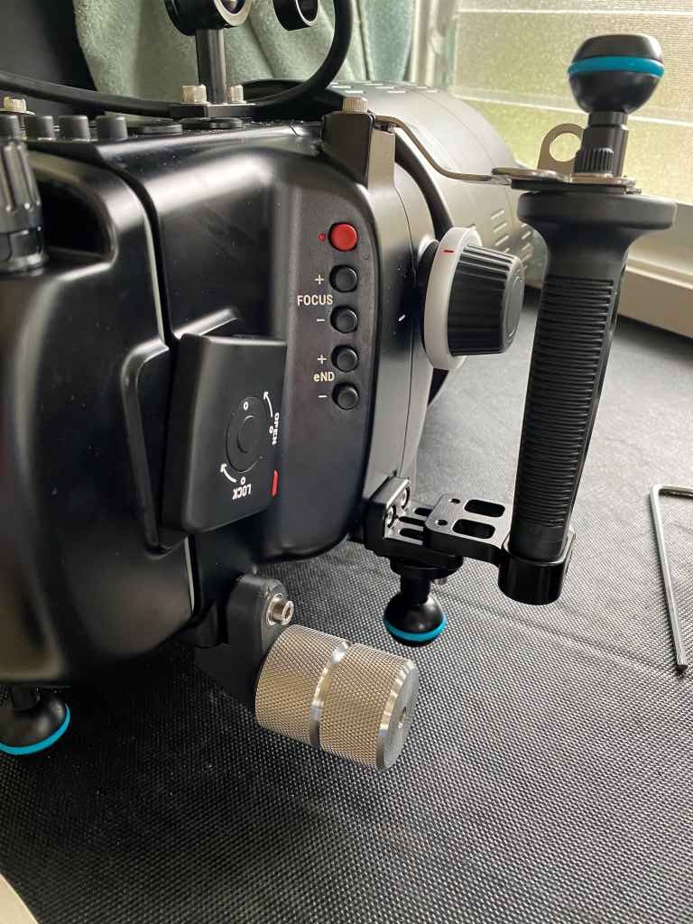

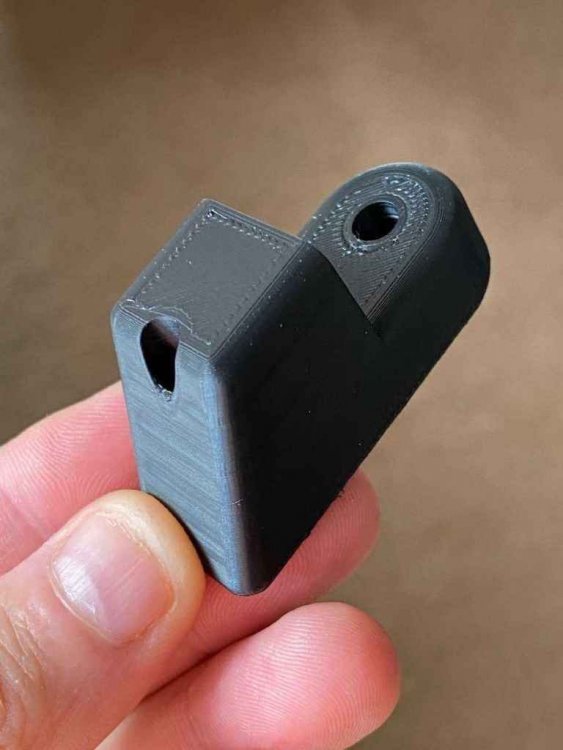

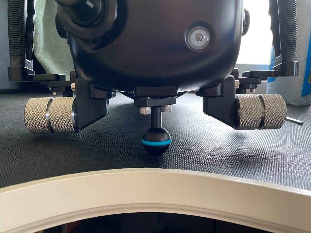

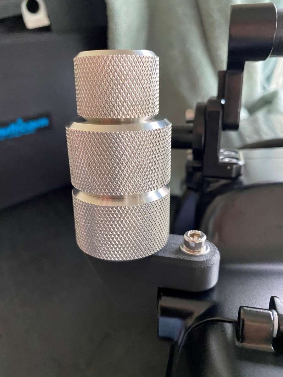

    Yeah, I 3D printed some plastic mounts for trim weights, so I'm not screwing them into the housing repeatedly.  I have 4 mount positions around the base of the housing so I can move the weights to where I want them.  They are low on the housing to keep center of gravity low, and stable.  The weights are 200g and 50g stainless steel counterweights for a topside camera gimbal.   Wetpixel will only allow images up to 1MB, so I put the images in a Google Drive folder.  Let me know if the link works:

    IMG_2758p.thumb.JPG.04e60909e74906ded645623a90bc3bd2.JPGIMG_2757p.thumb.JPG.6d4c676b85bdd76ef893b2d4ea54fae7.JPGIMG_2760.thumb.JPG.76162a04d552bfb5be7d2af167d4bca3.JPGIMG_2754p.thumb.JPG.1d6b83566d245cf5a08b20eb1d30f8a9.JPG
    Really a clean and nice work. I would like to copy the idea but on my GH5 setup I have the opposite problem: I have a policarbonate dome port so it tends to rotate "nose up". I had to put an ankle weight on it as a collar and then add a lot of buoyancy on top.

    I love it, I'm shooting ProRes Raw to the Atomos Ninja monitor/recorder.  I have the Nauticam WACP and Sigma 18-35mm f1.8.  Very well balanced now with the trip weight system, I can let it go and it sits perfectly level.  Nauticam also make a skids/trim weight system, but I just decided to 3d print my own system.
    -Brian
  6. Hi @bgreene,
    Can you share also your 3D files ?
    Thank you in advance !
