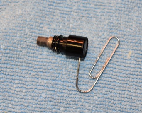

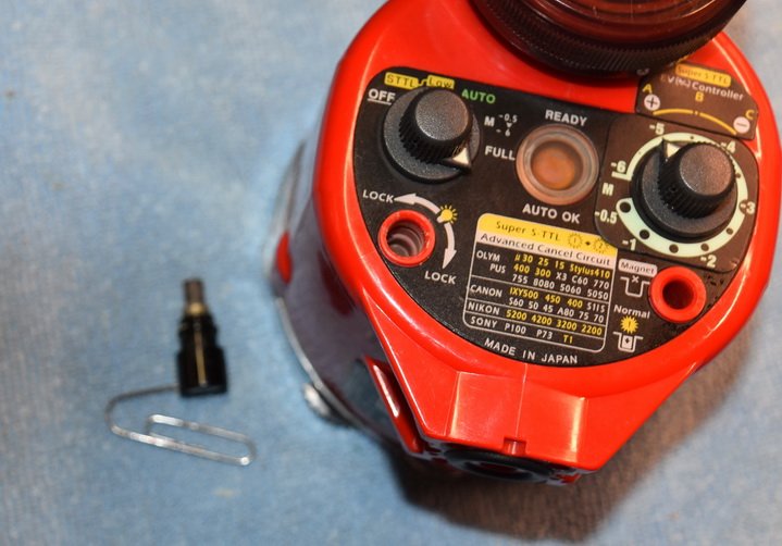

  9. This is how to remove the magnet, from a 2019 post:
    "On the Inon Z240, D2000 and D180 (and probably other Inon's), the push button assemblies for the light and TTL, located on the strobe's back,  unscrew from it for access to the magnets, without having to open the strobe case.
    "Push the button in (don't turn it) and push a wire or a pin through the holes on the site to fix it. Than turn out the whole thing anticlockwise. This is by the way also the method to open the light switch button."
    wetpixel.com/forums/index.php?/topic/43696-z240-manual-problem/
    Best of luck!
    Edited December 23, 2019 by Kraken de Mabini"

  11. New magnets arrived. I removed a magnet button from one of the strobes, and it was clearly corroded, the magnet was in 2 pieces. I inserted the new magnet button tried test shots again with magnet button pressed down and z240 in manual mode. I could still only get it to fire at around 25% power in manual. If I went higher, the no flash was the result in the image, and the flash clearly fired before the shutter was open.
    Then I tried to leave the magnet button in the up position, and now suddenly my flash can fire a full dump in manual mode. I repeated test with my other flash and had the same result.
    I'm pretty puzzled about this result as everything I have read indicates that z240 work in manual mode with magnet button down where flash should ignore pre-flash.
    When using my old setup with the 7D  in TTL mode, I had the magnet switched pressed down. But back then I didn't think about it, as I probably didn't know how it should be, I was just happy because it worked.
    So anyways, I'm happy that both my z240s seem to work on manual now with full power, but still somewhat puzzled how the magnet switch seems to be opposite than what I read about it. (Or maybe I just misunderstood everything). One more thing to note: TTL mode also works better for the R5 with the magnet switch in the out position.
