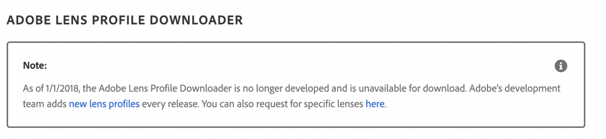

    Just FYI to others, I went to go look at this and it looks like Adobe no longer supplies the image (see attached screenshot). I'm sure I could find it on the Internet somewhere if I really wanted to.
    I wonder if I asked Adobe to add a profile correction for an underwater wet lens what their reaction would be. Maybe I'll try just to have a little fun. :)
