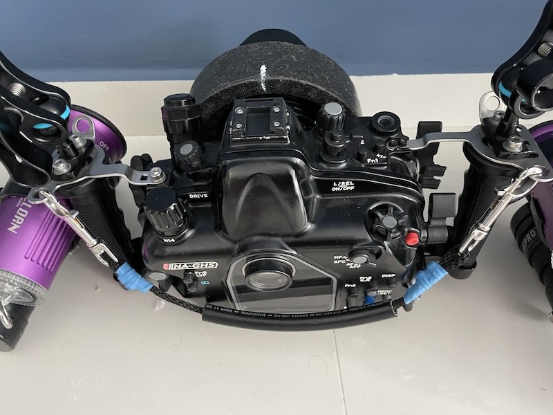

    Crotch or butt  d-ring are not a viable option because then the camera hangs below/behind you with no control. Crotch d-ring can be a temporary storing option if you are not using a dpv and you are midwater but again not really the best place. Options are left shoulder d-ring (can be problematic if you are carrying more deco stages and have to do gas switches or move tanks) or right shoulder d-ring. If you are trained in longhose management then there is no problem in deployment while having a camera there, you just have to make sure that the camera lanyard is long enough to allow you to push the camera under your arm but not too long to allow the camera to move around too much.
    In the picture you can see what I use. Gives me plenty of options to handle the camera. Happy to explain more if you want.
