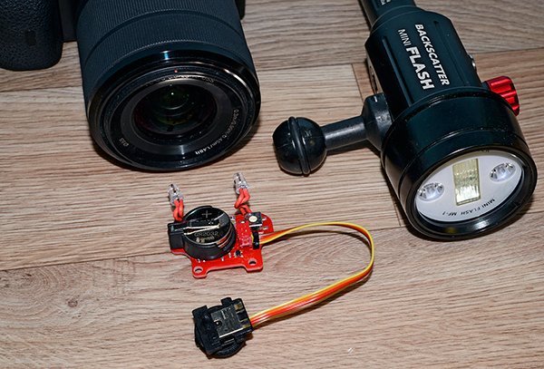

  2. UWTechnics triggers support Backscatter Mini Flash.  They all were updated specially for this strobe in September-2020.
    As example, this is product #11075-HSS i tested with Sony A7-A9 and MF-1 strobe:
    Edited by Pavel Kolpakov

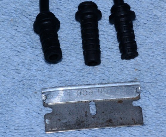

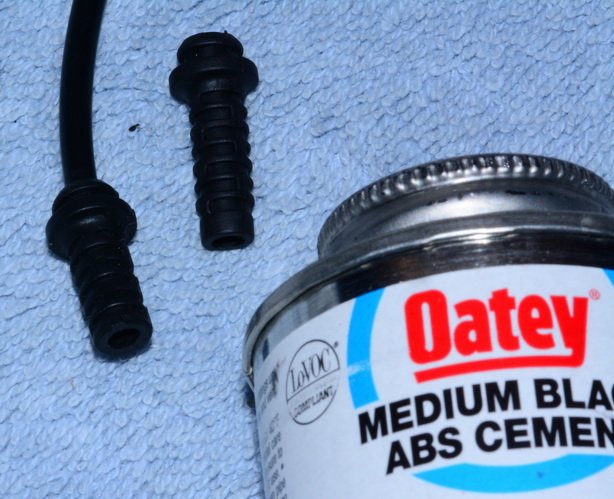

  7. TosLink cable, 2 to 4 mm single fiber and Uxcell strain relief plugs 7 mm od from Amazon or eBay have worked perfectly for me for the past several years, used with Sea&Sea and Inon strobes and Subal, Isotta and Nauticam housings.  I wrap a  1 meter long cable around the strobe arms to take up the extra length and keep it out of the way. A drop of ABS plumbers glue adheres the cable to the plug, then I trim both with a razor.  eBay and Amazon have low prices and prompt delivery.
    In contrast, coiled cables are thin, break easily,  the coil gets in the way and catches on things; unreliable and best avoided. Plus they are expensive, cost many times more than TosLink cables.

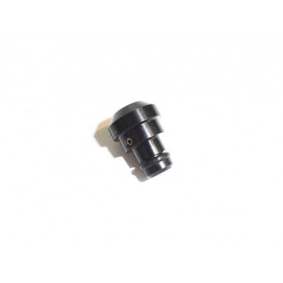

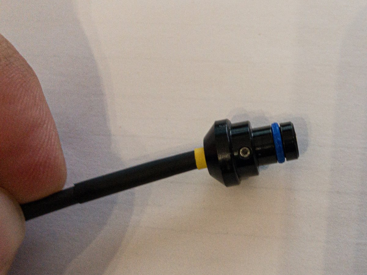

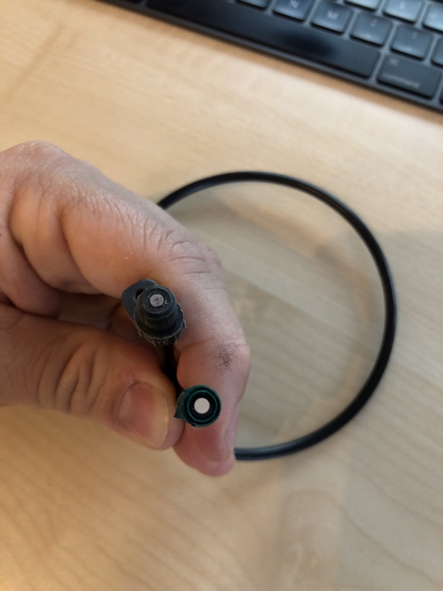

  13. I'm still looking for a cheap way to get Sea & Sea connectors for self-made cables. The plugs should also fit thicker cables up to approx. 4mm.
    Thanks for your help.
    Tino
  14. If you have S&S connectors from an old dead cable you can just snip them off and drill them out.  Run your fiber into them, add a dab of glue to hold it in place and you're good.
  15. You can get that exact connector for $8 or so from fun-in.image.png.ca8b566041e47e37a5d5cac2519a0e2b.png
    or 3-d print some for cheap if you have a printer. There are a bunch available on yeggi but I haven't tried any
    Bill
