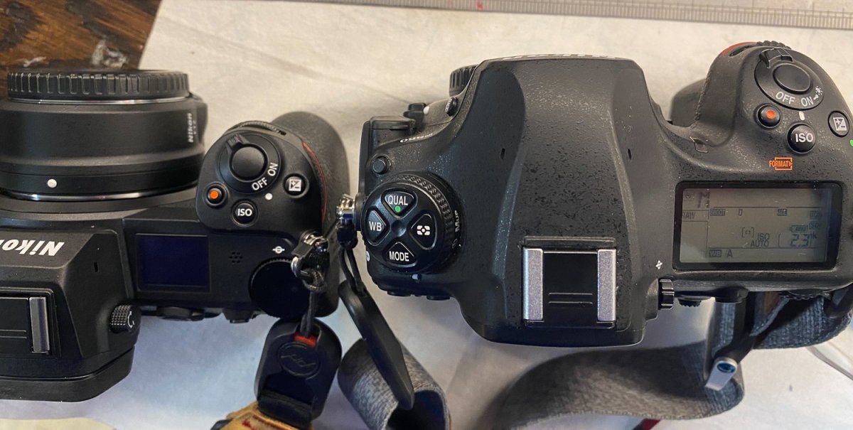

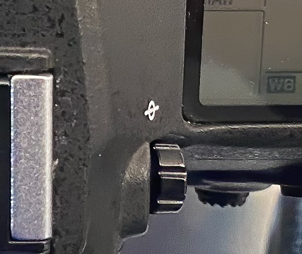

  9. The purpose of the FTZ is to bring the lens to the same distance from the sensor. I took a quick (and not Scientific...) shot of my 2 Nikons. On the right is Nikon D850 and on the left is Nikon Z7 2 with the FTZ. The location of the sensor in marked on each body with white icon.
    Edited by ido
  10. Interesting! Thanks.
    Yeah, the sensors are pretty much aligned and, just as important, with the added FTZ the lens mount seems pretty much aligned as well. So the lens front end should be broadly in the same position in the dome port as it would with on a Nikon F mount camera body.
