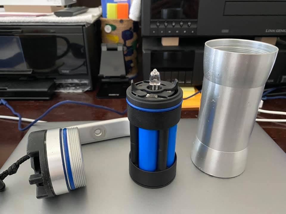

  6. Thank you for the response, appreciated.   I am a Inon friend, will seriously look into that.   Today, I went through some stuffs and found my other beloved Hartenberger Nano also pronunce death.   Try to open it up but stuck & don't want to over power it.  Not sure if it can be swap with regular AA battery or it has to go back to service.  Not even sure if I can find service, it's even older than my L&M.   So at the moment, I have no light, period !

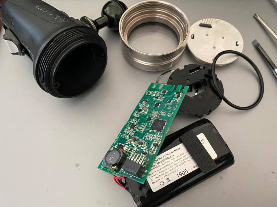

  7.
    Since L&M won't service my 1200 any longer, doesn't hurt to try take it apart myself.   So it's a 7.2v 3100mAH battery but it has 4 leads which I need to figure out why and what they do that for and see if I can find a replacement, size is the issue.

  8. I had a battery go bad on a Sola light as well, and the light was so old, they would not service it. So, like you, I took it apart.  I figured that I couldn't make it any worse.  I appears to be two 1850 cells with some electronics on top.  As far as I can tell, the two red and two black wires are simply in parallel, possibly to carry more current, I guess.  I hope that helps.  If you find a source, please post it, and I will be buying some, too.
