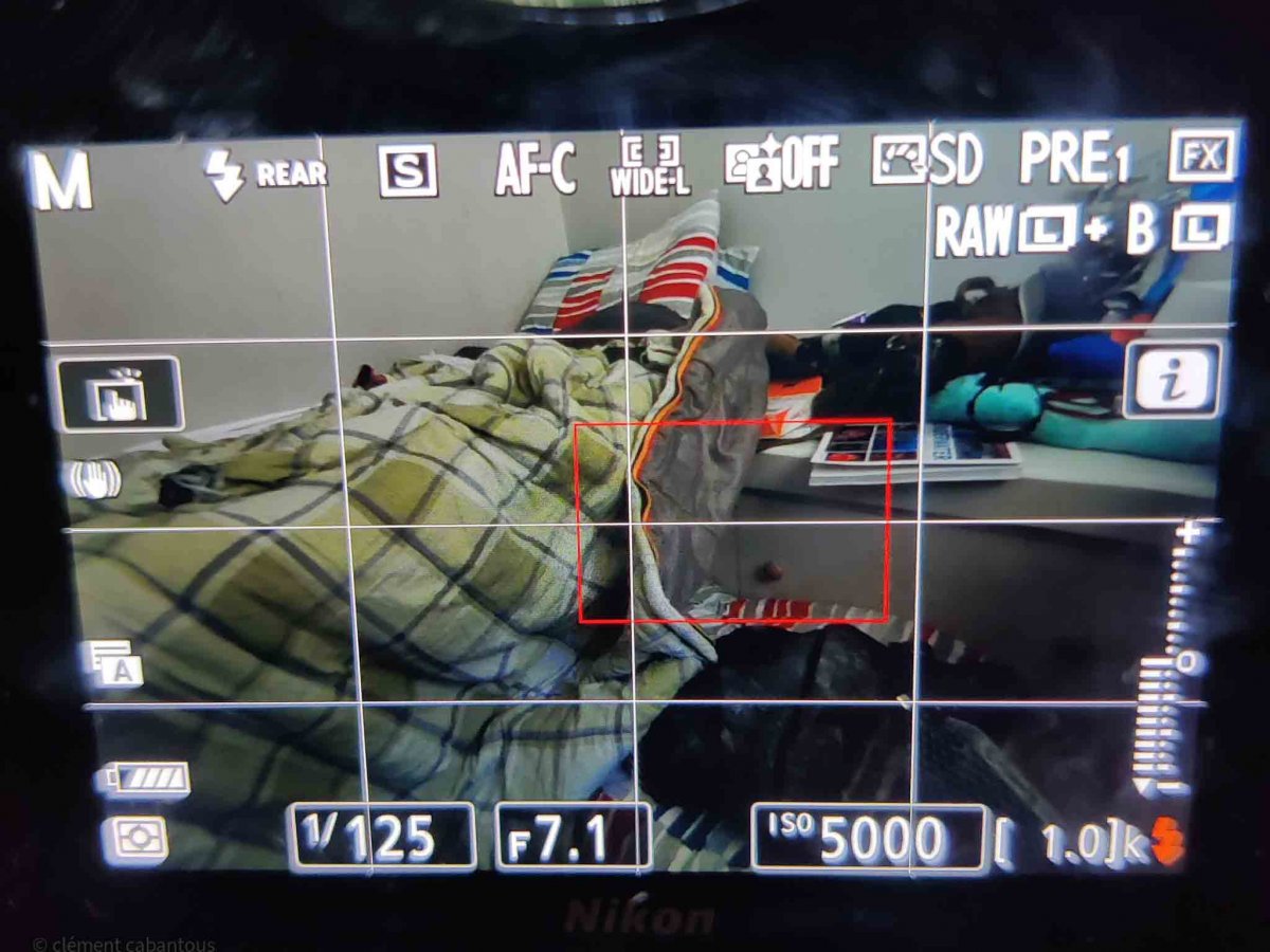

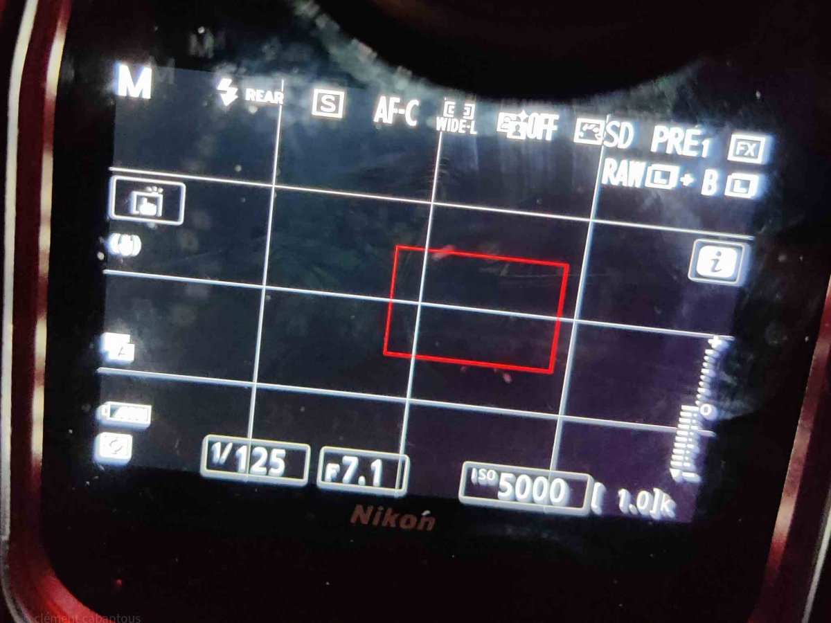

    Here are some quick photos of the screen, to show the two "différents modes" the camera produce, without I touch anything
    It always alternate between this two.
    So first it will be like on the first photo, with exposure correction, and you can see a orange thunder on the bottom right. With this mode, even if the strobe fire, it will not be seen on the photo
    Then after I took the first photo, it will alternate with the second photo, where the screen doesn't compensate low exposure. The orange thunder is not on the bottom right. I shoot the photo and the light will be seen on the photo
    Then it will come back to the previous mode and etc...
  6. The screen shows you are using rear curtain sync,  your trigger/strobes  may not support this, so maybe try without that turned on - instead try fill flash .    What modes are you using on your flashes - I believe there is manual with and without pre flash - try both of them.

    What I don't understand is why the camera change behaviour every photo like on the photos?

    Just to clarify your rear screen shot 1 shows the flash ready orange lightning bolt.  When you press the shutter release, the image has no flash illumination.  You say even if the strobe will fire - does the flash fire everytime or only sometimes?   I also assume if they fire both strobes fire?
    Screen shot 2 with no flash ready - the screen is dark when you take an image the strobes fire and the strobes sync correctly.
