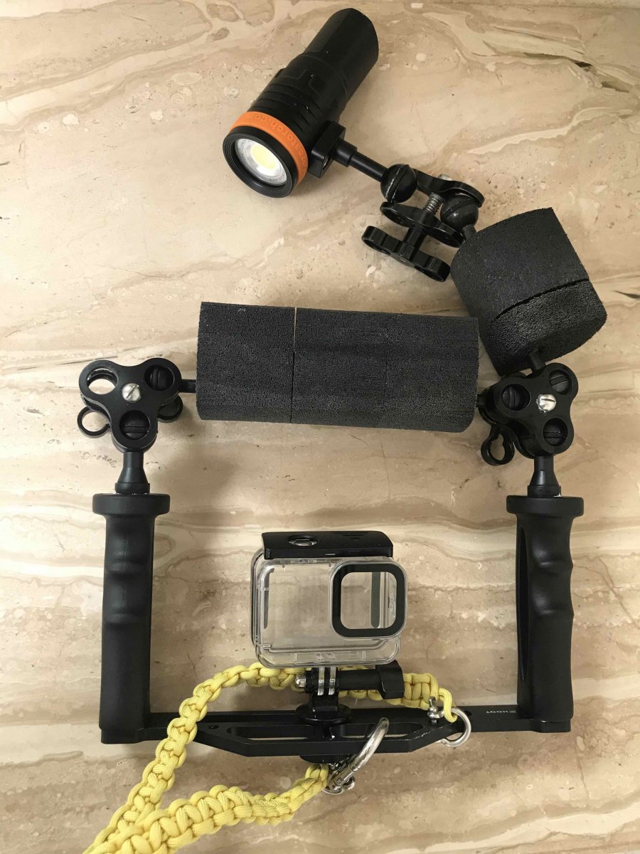

    Yep, my partner found the same with the GoPro. She's now got a tray with two handles and an arm between them loaded with Stix floats plus an arm for the light. 815gms of buoyancy in total. Even then it's pretty negatively buoyant - hence the lanyard! See photo.
