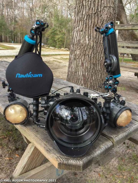

  3. In water, according to Nauticam it weights 0.27kg, that is less than WACP-1 weights ay 0.32kg in water. Have you actually tried it out in water because it seems that trim should be easy at only 0.27kg or 9.5oz. I have used Nauticam 50x250mm float arms with the WACP-1 and they worked quite well. I also like my system a bit negative so that I can put it down without it drifting away. I also use the dual strobe system with the two float arms outboard and the two ball arm sections connected to the housing. Same configuration in the photo with a Nauticam 180mm dome port.
