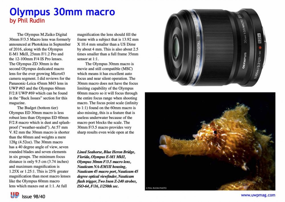

  2. I have used both lenses and don't recall much difference in AF speed even though the Pama lens is a bit faster at F/2.8. I did an full review of the Olympus 30 macro in issue #98 of uwpmag.com if you are interested. I also reviewed the EM1 II in an Ikelite housing for the same issue. uwpmag.com is a free PDF download and the back issues are at the top of the home page. If you enter my name in the search engine you can find other Olympus and Olympus releated equipment as well.
