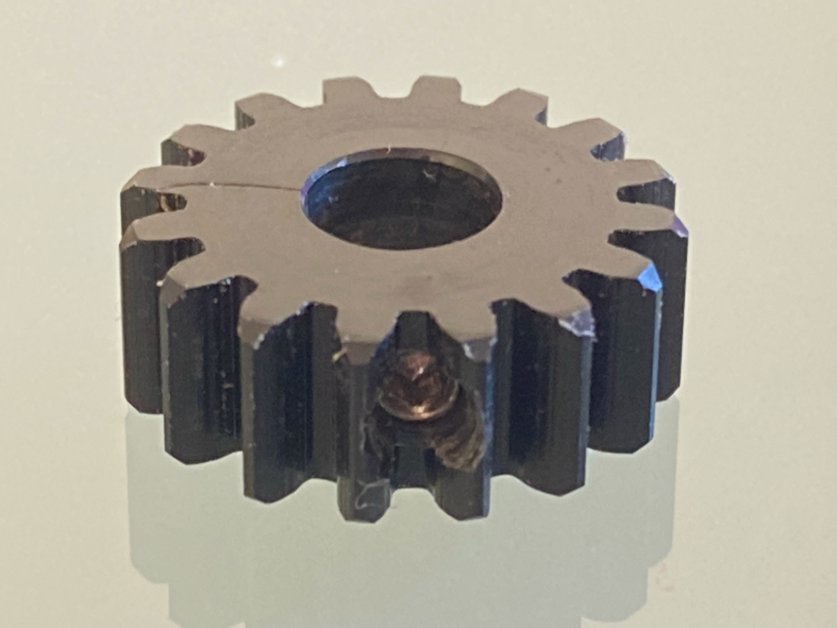

    I disassembled the mechanism and found that one of the gear wheels of the mechanism is cracked, and is responsible for the problem.
    In the movie you can see the problem of the mechanism, https://youtu.be/cIYewkvQmF0, and in the picture you can see the cracked gear wheel.

  7. It is not a rubber belt. It is a timing belt.
    in the movie is possible to see that the knob gets sucked always on the same spot of the gear wheel. And time to time the gear jumps dents on the cracked part.
    the gears on the other side of the timing belt are running smoothly.
    I believe that when assembling the gear wheel, too much strength has been putted on the screw pin and the wheel got cracked or at least weakened. With time and use it got worst.

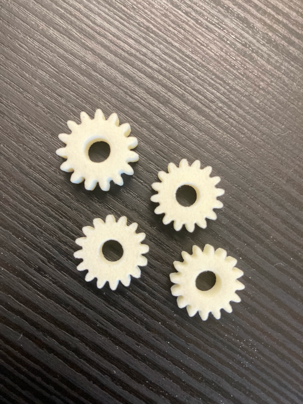

    For sorting the gear wheel, I found a fantastic site that allows us to design in the site the gear you need and them they have a service to print it in 3D, in a plastic material that gets more resistant than the injected mold plastics.
    https://www.igus.com/info/3d-printing-service
    Picked up the pachymeter again and developed the part in the cad system just with the input of some of the parameters, like number of teeth, module, width and hole diameter. 4 parts ordered! 3 to replace the broken one and the other 2 that work together with that, to avoid different materials to be working together and one extra for any accident on the assembly.
    At that moment, I still needed to get the “exquisite” screws for an European (non UK). And also some grub screws to fix the gear wheel…
    I found an UK site that have both US sized screws and Metric. And so, I ordered from www.accu.co.uk a pair of screws to replace the damaged ones, 5 grub screws M2.5x3 and a drill to apply the grub screws to the gear wheels.

  14. Well, finally I have my housing working and in good shape.
    The new 3D printed gear wells arrived, also all the hardware (the damaged screw replacement, the grub screws and the drill) also arrived and I have been able to install it back in the housing.
    I became a fan of the gear wells 3D printing site (and other bits)! I got it quicker and cheaper than from the housing manufacturer.
    It is working, and back in place. The vacuum system assures that everything has been mounted back in the proper way.
