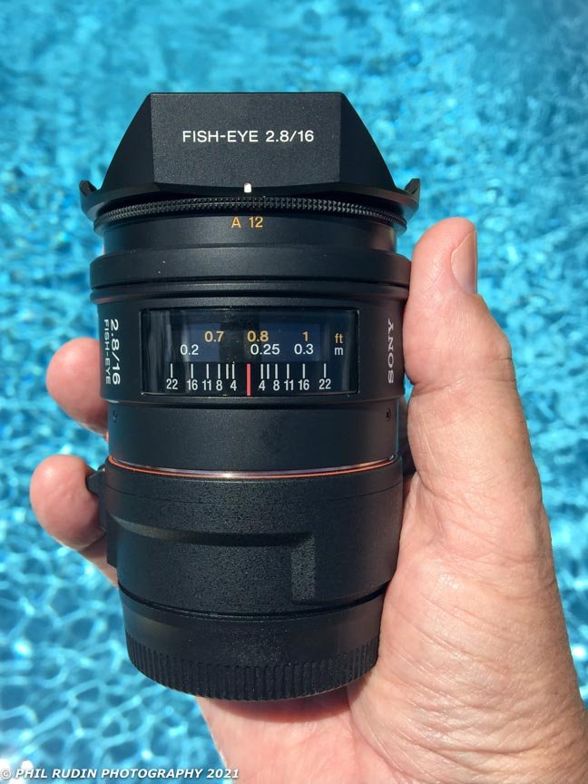

  11. If you are at all nostalgic Sony has recently introduced the E-mount LA-EA5 lens adapter. This adapter allows the use of both Sony-A mount and Minolta lenses. That means it can be used with SSM and SAM lenses with full AF even the lenses that don't have a motor. This allows you to use among others the Sony 16mm F/2.8 Fisheye, the 200mm F/4 macro and many other lenses that can be found in the used market. The Sony 16 fisheye does not focus as close (21cm) as many more modern fisheyes like Canon 8-15mm at 15cm but the Sony can get the job done it you are not shooting very close CFWA. The lens also has three built in filters, A 12, O 56 and B 12. This is not a lens I would necessarily recommend it you don't intend to use the adapter with other A-mount lenses. I appears to work well in the Nauticam 140mm dome port. The LightRoom lens profiles look horrible but if unchecked the images look as shot.
    Lens and adapter photo.
