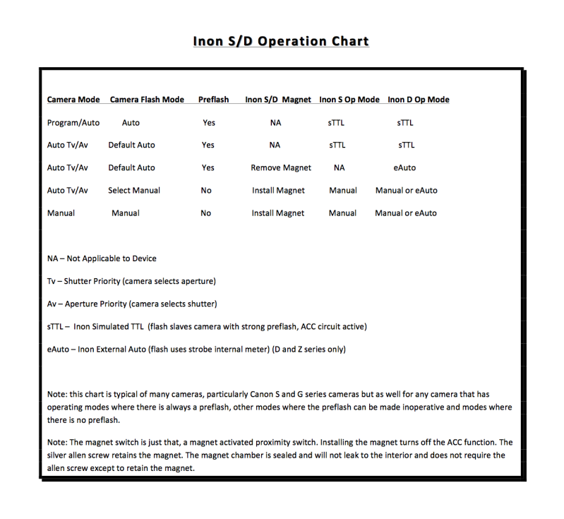

  9. In sTTL mode (the strobe switch selected to the sTTL position) the D2000, S2000, Z240 and Z330 will automatically expect a preflash and operate correctly ONLY when the camera emits a preflash (which your TGX always does if I remember correctly) REGARDLESS of the magnetic switch (in or out) or with the Z240 and Z330 selected to either preflash or no preflash on the selector switch. In other words, to be more simple, the sTTL selection over rides the magnet switch and it does not matter whether the magnet is in or out for sTTL operation.
    The above chart I made for Canon S&G series cameras, since your TGX always fires a preflash and your S2000 strobe does not have the  e-Auto mode, you only have Manual and sTTL as choices. For Manual operation of the S2000 strobe with a camera that fires a preflash, remove the magnet. For Manual operation of the S2000 with a camera that does not fire a preflash or can be set not to (like a Canon S or G series), install the magnet.
    Since you are operating the strobe in sTTL and your TGX always emits a preflash, I suggest you remove the magnet (but do not lose it) as it makes no difference in this set up.
