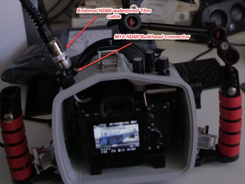

    You could try something like this:
    https://www.diveandsee.com/products/underwater-cables/DNC-1120-Underwater-Full-HDMI-2.0-cable-4K-60fps-for-Live-video
    You would then just need a HDMI bulkhead installed on the housing.  They could probably supply one but may need to be a custom item as Ikelite don't use metric threads on their bulkheads as far as I know.
  3. You can use bulkhead connector DNC-2091 for your Ikelite housing with any external HDMI cables, depends from desirable length, for example 30m DNC-1066
    Ikelite 200DL Underwater Housing for Sony Alpha a7S III Mirrorless Digital Camera with Dive And See cable bulkhead connector.jpg
    Ikelite 200DL Underwater Housing for Sony Alpha a7S III Mirrorless Digital Camera with Dive And See HDMI cable and bulkhead connector.jpg
    Does the ikelite housings now use M14/16 threads for their bulkheads - I thought the older housings used imperial thread for that purpose?
  5. At least latest housing for Sony a7siii has threaded M16x1 port.
    Previous housings had 1/2-20 threaded spare ports.
