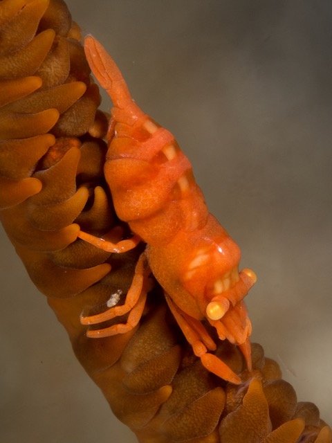

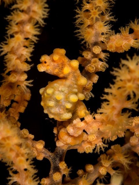

  3. Listen to Chris!  I've been shooting macro in Anilao for a long time, using OM-D cameras in Nauticam housings with the 60mm macro lens.  I started with both the +5 and +10 SubSee diopters.  After a year, I gave up the +10 as it is very hard to focus and light with that lens given the very short working distance and it did not produce better images compared to the +5. I have no experience with the CMC variants so take it for what it is worth.  Here are three good examples of images taken with the 60 mm lens and +5 diopter.  All three subjects are roughly centimeter size, the pygmy and whip coral shrimp perhaps less.
