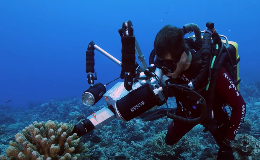

  1. I was watching an episode of the latest Laurent Ballesta expedition in French Polynesia and he was using a quite long lens to photograph some fishes hidden inside corals.
    Am I wrong or is that a camouflaged Nauticam EMWL lens?
    I know he is sponsored by Seacam but I guess that EMWL was the right tool for the job ;)
    Here the full episode:
  2. I don't know that it's camouflaged as such - looks like he has taped on some flotation, the lenses are quite heavy the average kit weighing around 1lg in water and on a long lever arm so getting good trim would be important.
  3. I've had a chance to play with all three objective lenses 60°, 100° and 130° on the EMWL.  Zooming in on the photo it definitely looks like the 60° objective lens on the end of an EMWL.

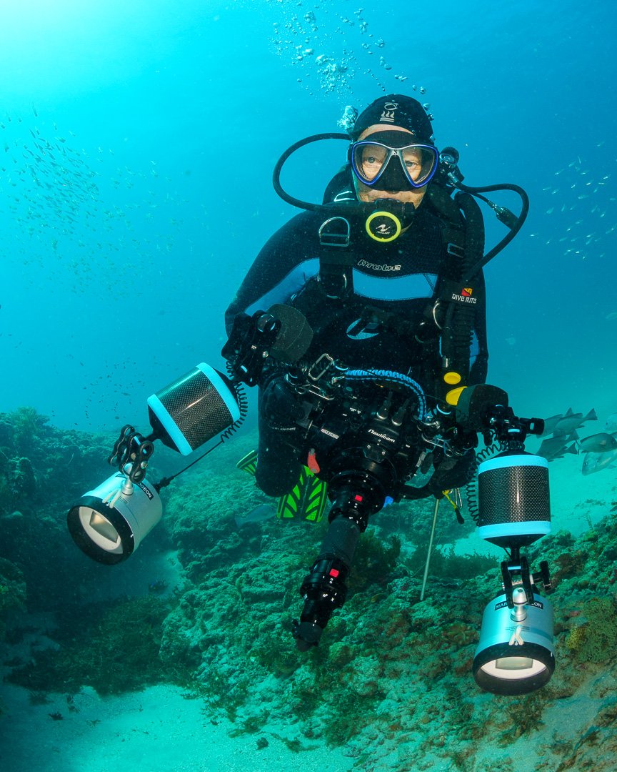

    Definitely flotation and not camouflage, the EMWL makes your rig VERY front heavy, specially when you push your strobes forward as has been done in the photo.  My solution was to replace the arms closest to the strobes with a couple of Nauticam 90x170mm float arms with 450gm of buoyancy each which balanced the weight of the EMWL very nicely.
    Here's a shot of my wife Mary who has the same setup as me:

    I am finding myself with the same issue Gudge, also compensating with my most floaty arms at the front, but this works well if not moving the arms much. When I start doing more creative lighting, this will straight away un-balance the whole rig.
    Hoping Nauticam are watching this thread (wink wink ;)) I can only vouch for them to design a solution, suggestions below:
    A custom float/collar that would fit around the relay lens. Fitting it there would mean limited disturbance when swapping front lens element underwater. Also, we need this to remain as sleek as possible, to keep the advantage of a tiny rig that marine life tolerates closer. There I see two design options:
    Option 1 (my preference): a collar + shackle system, which just clips around the relay lens. Makes it impossible to use the flip holder nor strobe mounting brackets (ref 87518), so the collar should come with some sort of shackle, making it possible to clip it on a D-ring on your BCD. Then, when i want to store safely my (fully assembled) EMWL out of the way, I take it off the macro port, add the front/rear caps, and just clip it on, next to the ton of accessories I am clipping anyways (Retra snoot, Retra macro rings, car keys, etc. etc).
    Option 2: this collar fits around the 87501 flip holder. Then you can use both (I can't see myself crawling through waves and rocks out of a shoredive with the EMWL still on my macro port).
    In both cases, I believe it's essential to keep the diameter of the whole thing as small as possible, in order to make it less intimidating to wildlife.
    In the meantime, I'll try to craft something myself but Nauticam would surely do a better job :)
