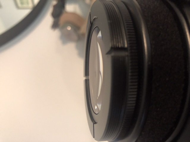

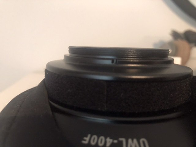

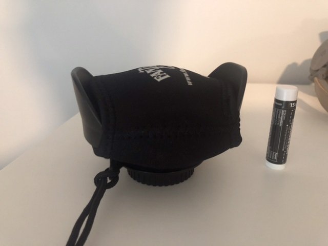

    Thank you both for the discussion ! I will order the parts and give it a try since I already habe the UEL-400F. @Barmaglot here are some pictures for you. The first is without the step up ring ans you can see nothing protrudes. Second is a picture next to a chapstick for size and the third with the step-up ring.
    Edited by VOL
  12. Thank you for the photos, but are you sure that step-up ring is not mounted in reverse? The knurled section seems to be wider than the M67 threaded part, so there is no way it could fit into a port.
    Still, the rear element looks to be flush with the threading, which means that if I mount it in a magnetic adapter, there will be extra distance between port glass and lens, and that will shrink the FoV. So much for that idea :(
  13. You are right - I turned the ring around and updated the photo.
  14. Thank you - yes, it's a flush rear element, good for screwing directly into a port, not so much for quick-detach adapters. Maybe I should look for a used Inon UWL-H100 Type1.
