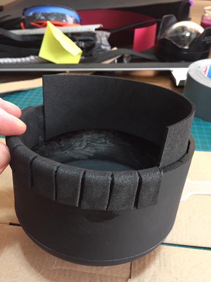

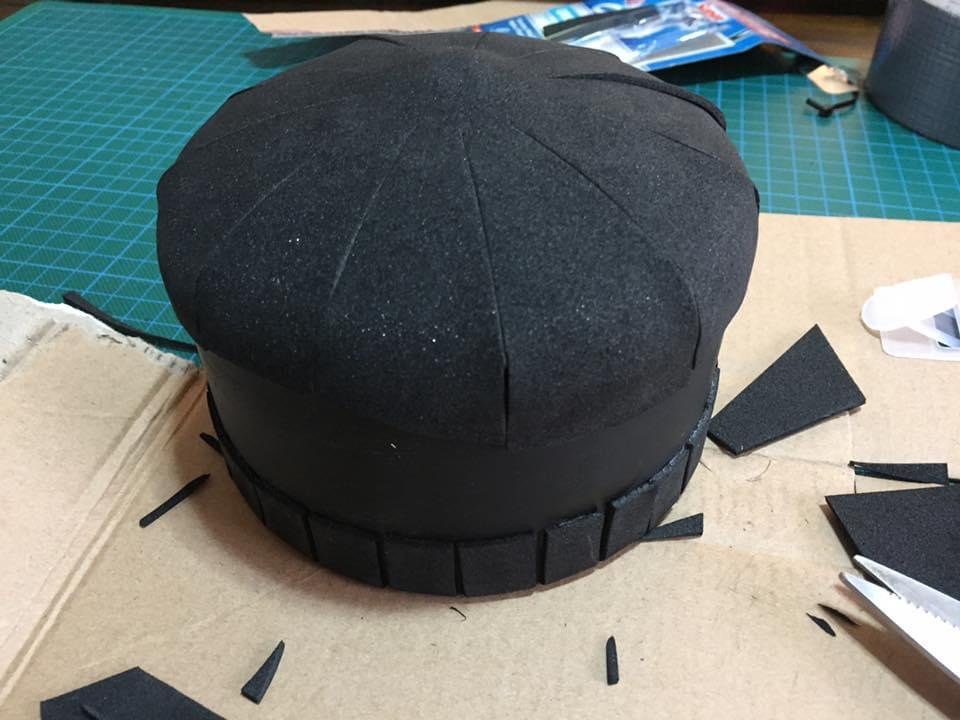

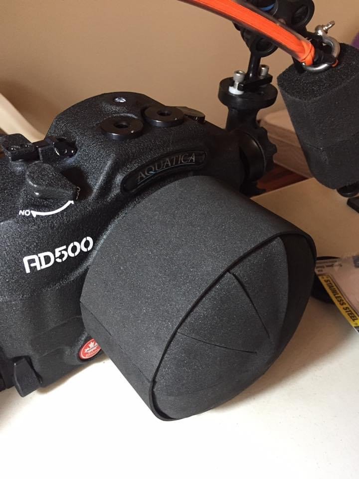

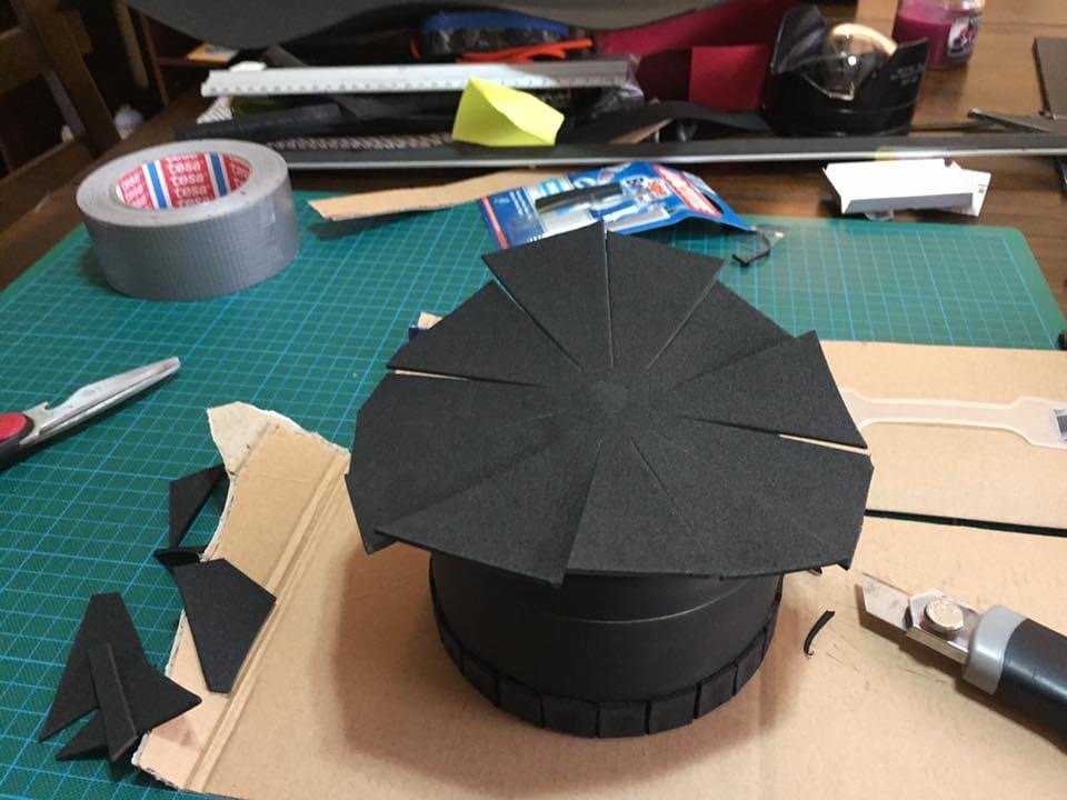

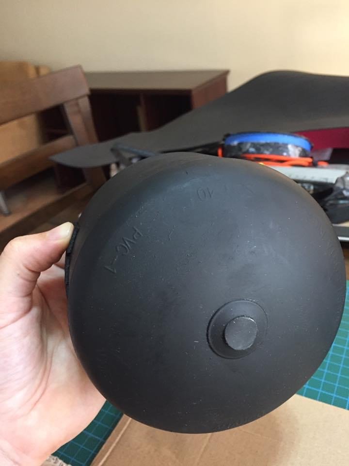

  2. I made a hard cap for mine with a sewage pipe end.
    I covered the pvc in a thin layer of foam sheeting from an art supply. Can’t find a photo right now.
  3. Yeah, I’d suggest a PVC piping endcap lined with foam to produce a tighter fit. Or a small paint pot or butter/yoghurt pot.

  5. Nice job, Chris!

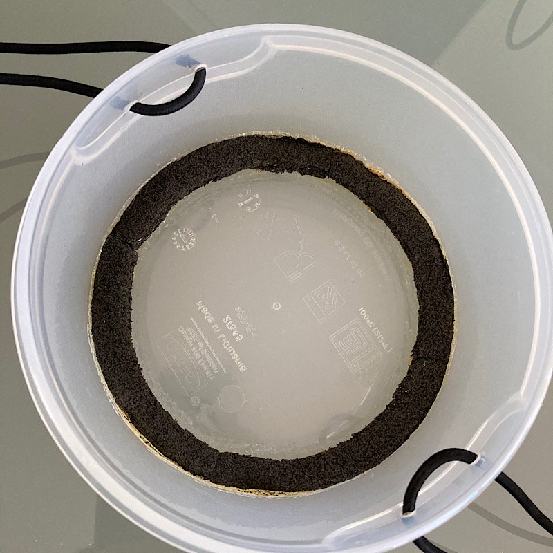

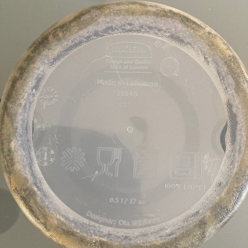

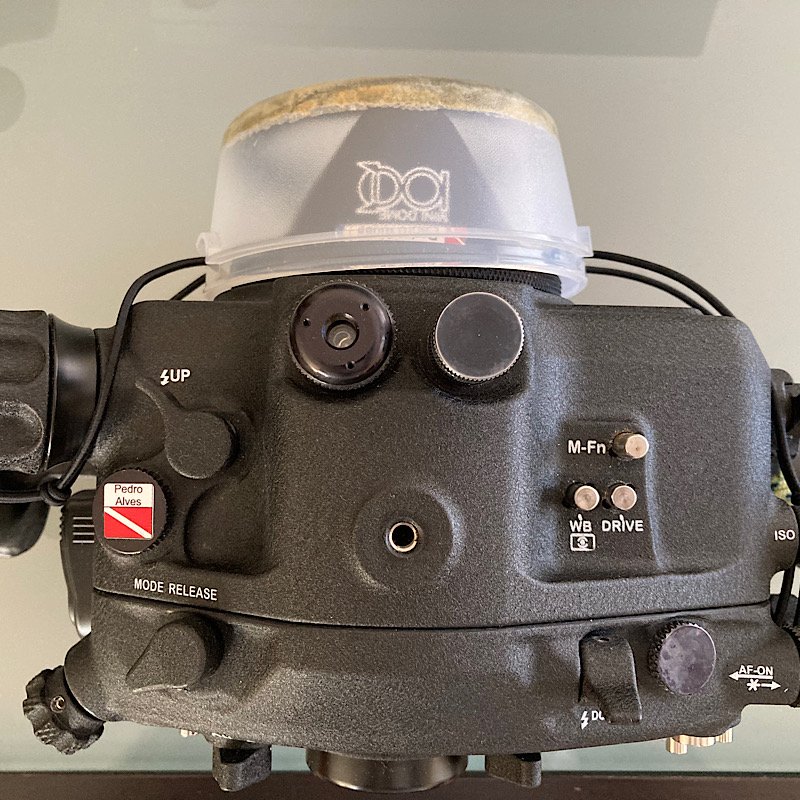

  7. I have solved my issue with a plastic food container from IKEA, a glued rubber/foam/neoprene inside, 4 small holes and a bit of bungee on 2 loops to maintain it in place.

  9. First, I thank all for the very valuable suggestions and demonstrations...

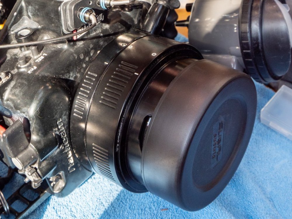

    I first went the plumbing-pipe route and found a rubber end cap that fits the port. It needs some extension via a cutted piece of pipe. This solution is, however, relatively heavy and so it is a good solution for usage at home, but not for air travel...
    Another member here, Kraken de Mabini, wrote me a PM and suggested to try the end cap of a Subal macro port:
    http://www.subal.com/a308c36c20c1/Housings/Accessories/Protective_Caps/Protective_cover_114mm.aspx
    I ordered it and it fits. The cost including mail was 27 Euro, I consider this o.k. As one can see from the photo, it is a little bit short and could be longer, so it is o.k., but not a perfect solution. It performs its duty, i.e. it protects the domeport. In addition it is light. Certainly a solution for peple outsde U.S. but within the reach of a Subal representative.Thank you Elias for this suggestion...
