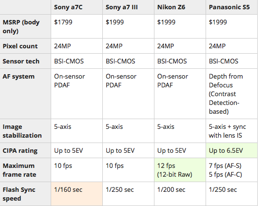

    This would help clear what the max sync usable is :
