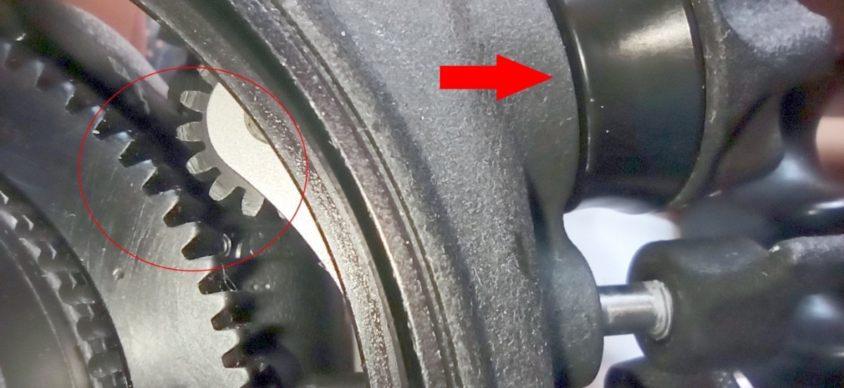

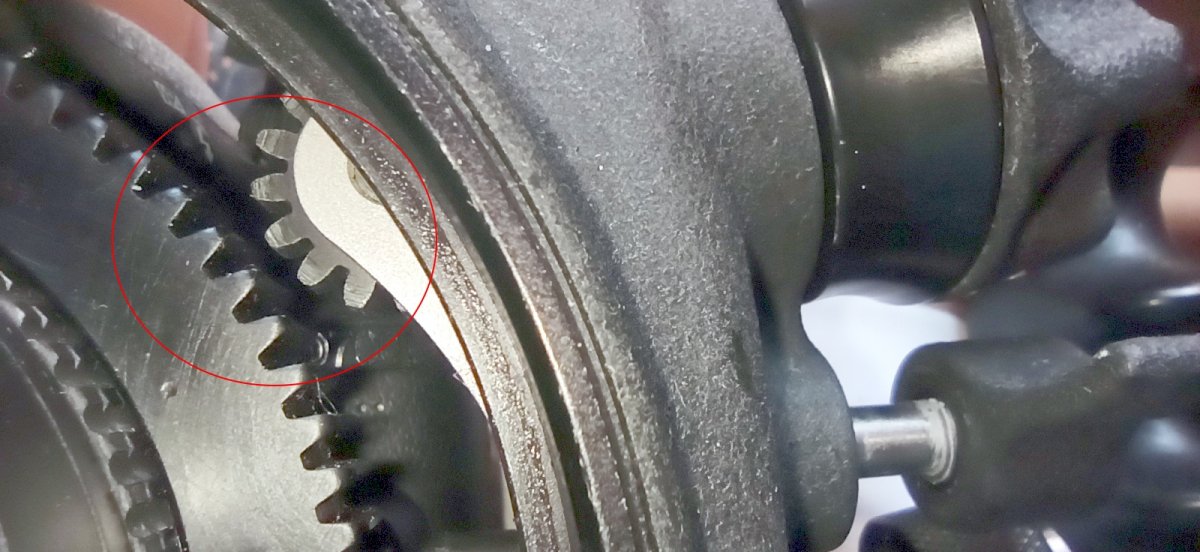

  6. Thank you Pbalves.
    In the previus picture you can see the pinion is unlock
  7. That why I asked for a picture of the mechanism inside. It might be that a part is misaligned.
  8. Is this a new issue for this housing?  By this I mean did it work in the past but now does not engage properly?  Or is this a new zoom gear that does not engage properly?  The cause may be different for the different cases?
    have you tried to see if there is more travel in the mechanism, by pushing it gently with your finger?  If you can move it far enough manually it may mean the mechanism is binding.

  10. Do you have the reference of the zoom gear you own?
    I noticed at
    My camera is Canon 7D MkII. it uses type 2 lens chart. for exemple, for Tokina 10-17 FE, it uses the 18717 zoom gear.
    The type 3 lens for Nikon uses the same zoom gear for that lens.
    The AD7000 housing uses the type 4 lens for Nikon, that for the same lens uses the 48717 zoom gear.
    It might be that the difference in the zoom gears is the external diameter.
    The dimension and number of teeth I gave you is based on the 18xxx type of gears.

    I don't believe the issue is focus vs Zoom rings as they all come to the right elevation to work with the housing zoom/focus control, they just don't reach the gear to allow meshing.  I found this press release from Aquatica and while it does not specifically state that the type 4 rings are bigger diameter it does note that the reason for the change was to accommodate larger diameter lenses.
    https://www.aquatica.ca/en/press_releases/d7000_new_gear_format_press_release.pdf
    The other thing to check is if the disc under the zoom knob (item 10 in the manual key diagram) is being re positioned fully and there are no stops preventing it being fully seated.  You could try emailing Aquatica they should be able to advise directly if what you are observing is due to having the wrong zoom ring.
