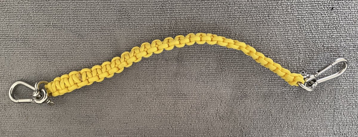

    3. I realize handling the setup UW during a real scuba might be more difficult, especially making sure I don't drop/lose anything. I've seen online you can get lanyards/handle straps for the housing. Is that generally what people use? And any recommendations?
    4. Any other general accessories you recommend having?
    Look for bolt snaps rather than carabiner loops as attachment points, example. If you have your housing mounted on a tray with handles, a braided cord handle that attaches on top of the rig is a convenient way to carry it around and pass it from/to the boat deck, example.

    Some sort of quick release connection between you and the housing is a good idea They’re really easy to make: a couple of carabiners and some Paracord  Have a look for the Cobra knot on YouTube and you can make what ever colour and length you want in about 20 minutes. And it costs pennies.
