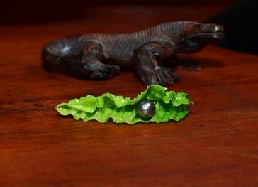

  9. To get a good working feel for ones camera and lights, it is a useful to practice dry runs at home.  For example, to simulate shooting a small squid in the ocean,  I modeled a small green squid, or fish, with a big shiny eye using a piece of lettuce and a 7 mm ball bearing.  The photo shows surface detail of the damaged ball bearing - surrogate "eye", with good "body" color and detail for the lettuce "fish". It would have been sharper if I had not had so much coffee, but you get the idea: test and refine details of one's photo technique using quick and inexpensive simulations.
