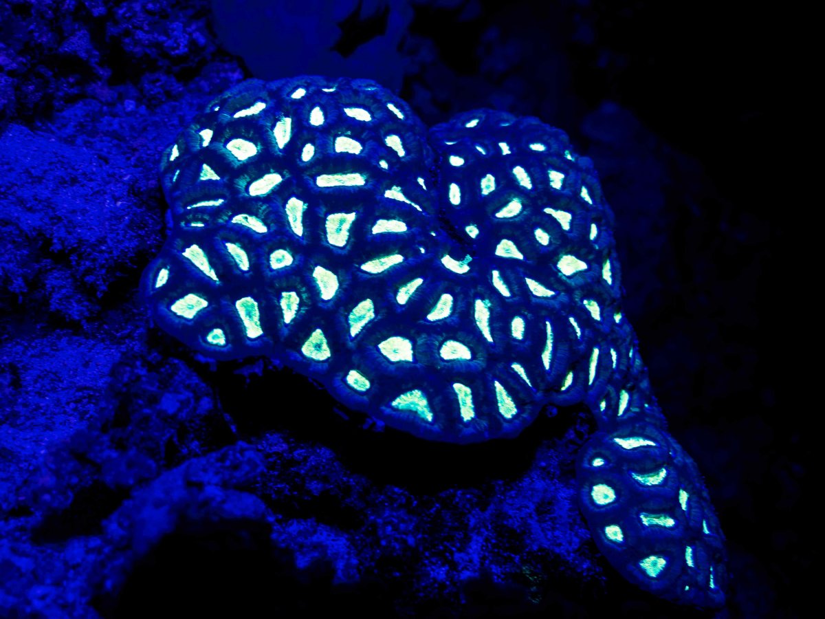

    It is possible to make fluorography photos without filters. The picture below was taken just with the blue LED of my WeeFine Smartfocus 2400, without any filters, and in LR the blue as reduced greatly, but not complete, and yellow was enhanced. I guess, however, that for serious fluoro-photos you will need a serious equipment including filters...
    Wolfgang
    EM5II; Zuiko 12-40mm @17mm; Zen DP170; ISO 200; f 2.8; 1/8s.
