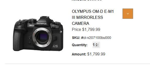

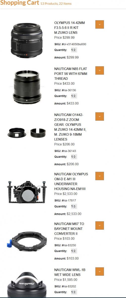

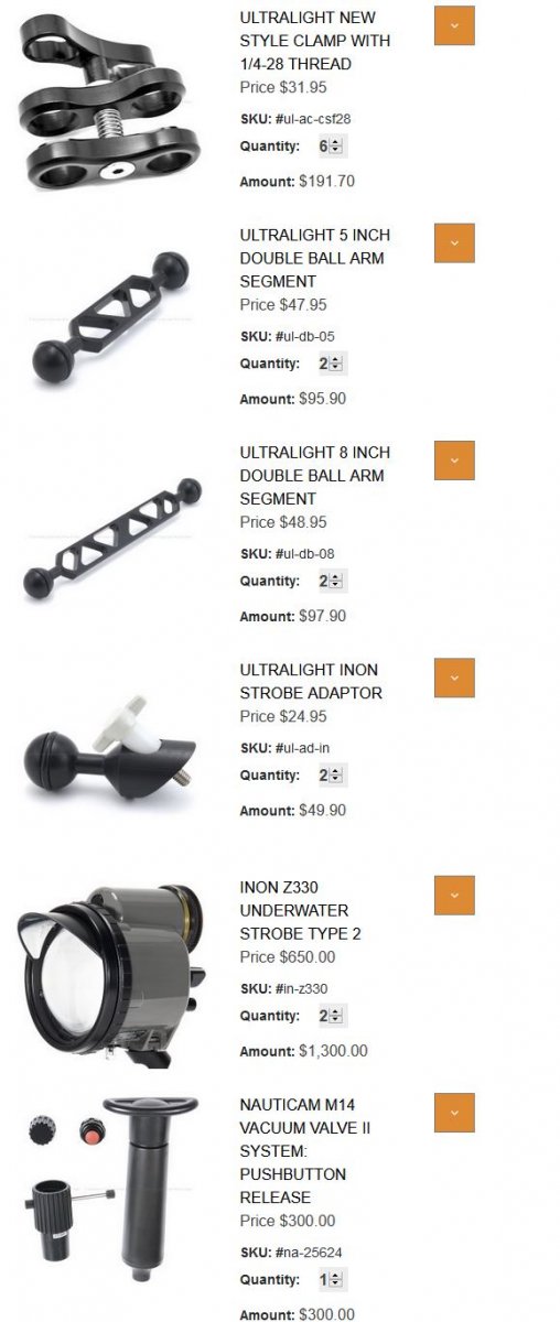

  4. WWL is a wet wide lens, a water contact optics they increases the field of view of the lens and allows it to focus closer.  This is the lens:
    https://www.nauticam.com/collections/water-contact-optics-for-nav/products/wet-wide-lens-1-wwl-1-130-deg-fov-with-compatible-28mm-lenses
    It gives a field of view about equivalent to a 10-30mm lens (full frame equivalent).  Here is a sample shopping cart with a setup to use the wet wide lens with olympus and Nauticam.  It may be possible to do the same with Isotta which will be cheaper but there's not enough info in the port charts to sure of selecting the right port and lens to work with the WWL.  I'm suggesting the WWL as it''s probably more economic than a big flat port and it's rated for 150m.  It does have a little barrel distortion, but certainly not in the fisheye range.  If you wanted a regular rectilinear like the Oly 7-14 lens most of the ports are not 100m rated.
    This is just one option, there's probably others you could look at .
