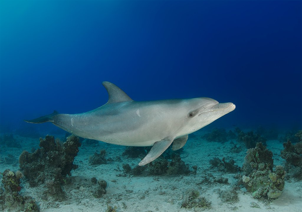

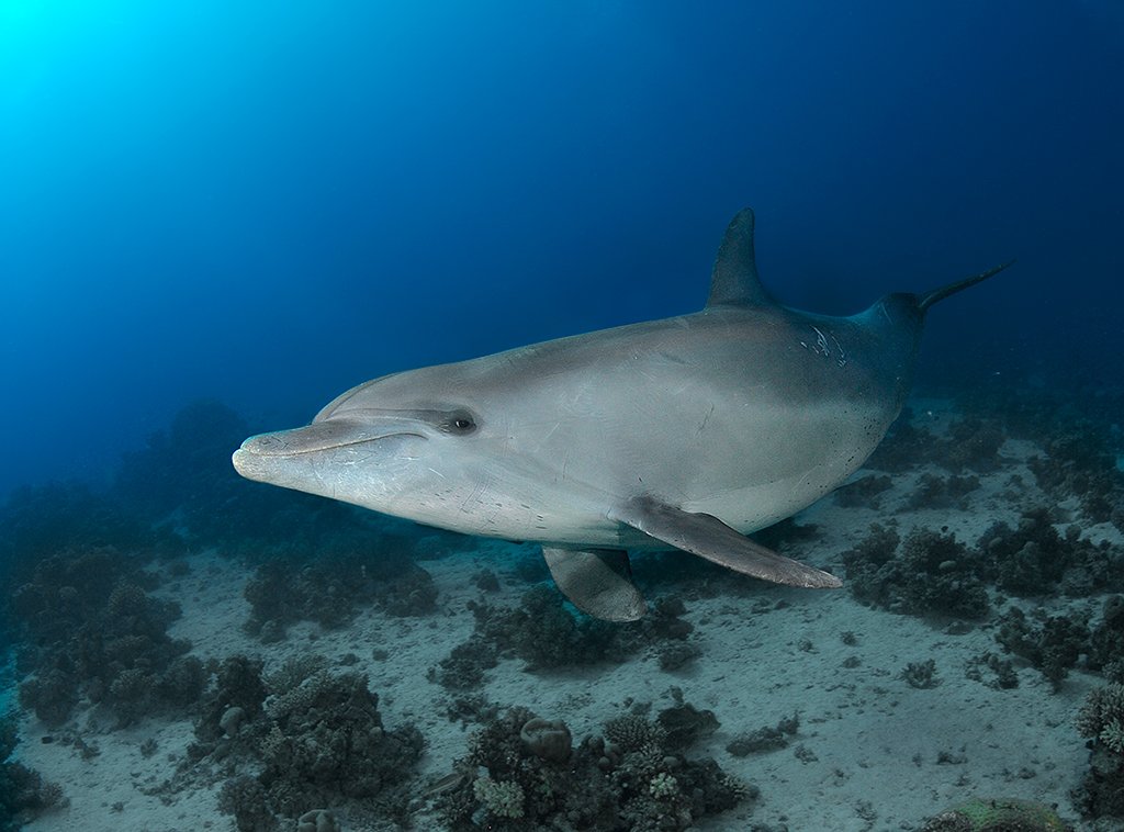

    My experience of photographing fast-moving dolphin pods was in the Red Sea. Two pieces attached as examples.
    Unless you can get really close - which from what I found was more luck than anything else - lead me to think something in the fisheye range is too wide. So not 15/16mm, 8-15 type lenses. Even the Tokina 10-17 I'd have my doubts especially on a full frame (FF) sensor camera like the R5 (see below).
    What worked for me with a FF sensor was a 16-35mm lens. Like you, no strobes. But this IS a big lens setup which is quite complicated to house on FF. It needs a big dome (230mm) to get sharp corners (more important given the speed dolphins move, I'd suggest) and needs to be stopped down to at least f11 unless you use the Sea & Sea correction lens. In addition it needs  something like a 90mm extension ring to get the correct distance between housing and port glass. So quite bulky. And expensive.

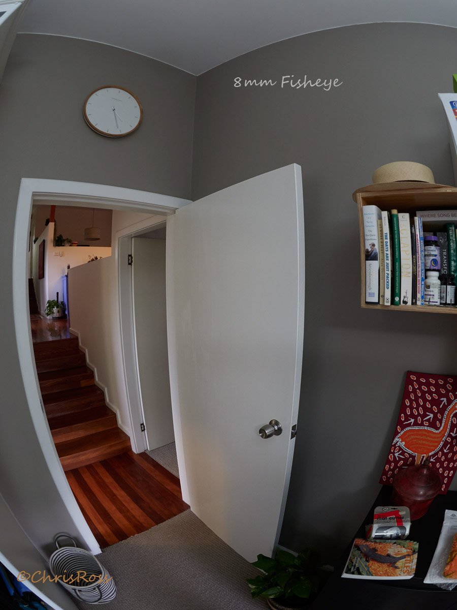

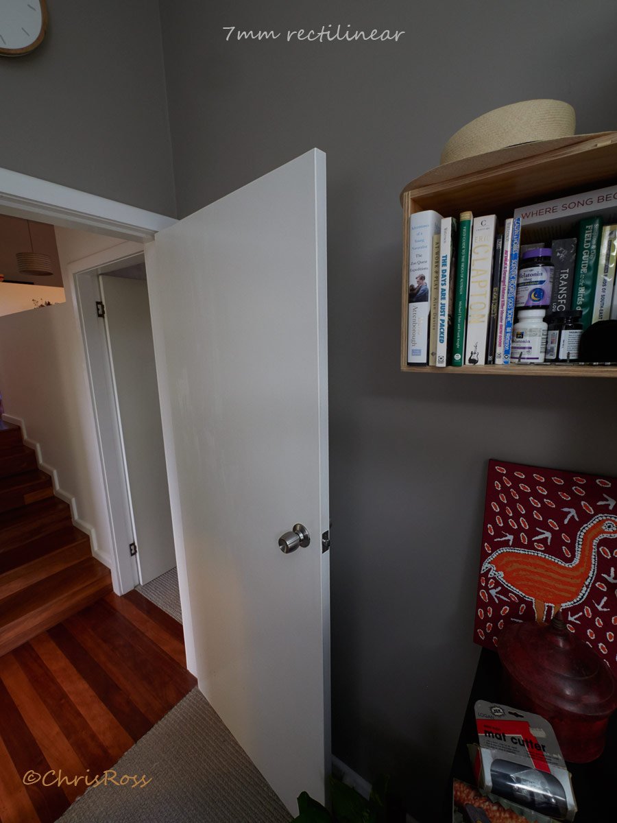

    Here's a comparison for you taken from pretty much the same spot you can see how quickly things get small at these focal lengths.  You can now compare sizes of the same object.  You can see the fisheye stretches out a lot more in the corners but the door is not hugely bigger in the frame with the rectilinear lens.  First is 7mm rectilinear - 14mm full frame equivalent and second is 8mm fisheye - equivalent to the 15mm end of the 8-15.  You can also see from the door in the BG how quickly things get smaller in frame.  The door edge closest is about 800-900mm away and the hinges of the BG door about 2.2m away.
    To my mind the 7-14 option seems a touch better if the dolphins are not always on top of you.  But a full frame 14mm zoom setup is going to be pricey and bulky.  A complete AOI EM-5III housing with the panasonic 7-14 and 8"dome adds up to $3800 at backscatter this would be ready to go - all you may want to add is a tray so you can use it two handed and it includes a vacuum system for leak checking.  You could easily spend this much just for the housing for an R5.  The downside is it is really setup to use the rear LCD not the viewfinder as far as I can see.

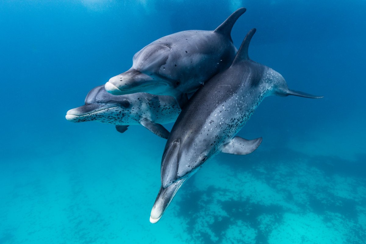

  17. Im using actually a Canon R5 in Nauticam Housing with a 15-35mm lens... the picture i have attached was taken with a 5DIV and a 16-35mm and a 8,5" Acryl Dome.
    If you have any questions about this, feel free. :)
