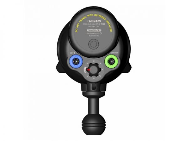

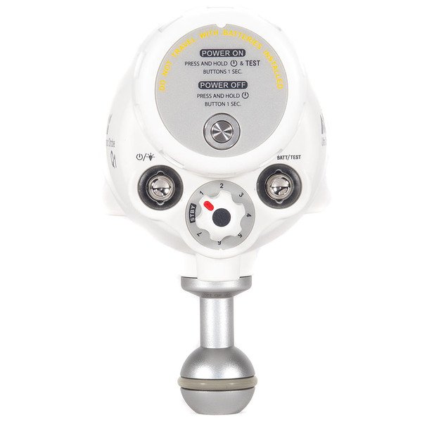

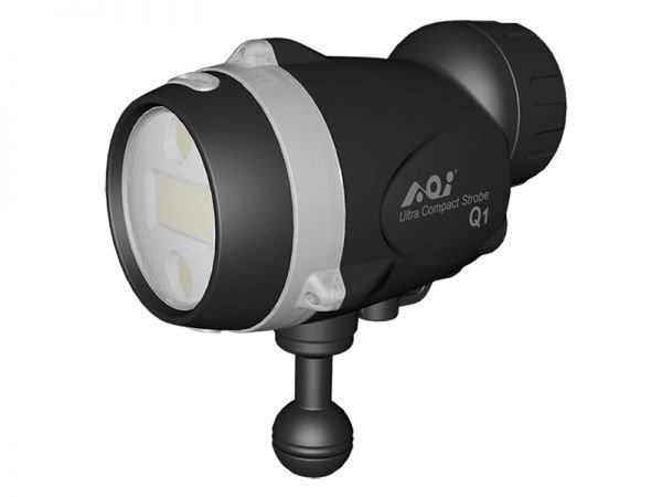

  1.  Backscatter sells it for $299 and the snoot for $49.99. It has no TTL that I can see, maybe that is why it has a low price relative to other strobes.
    DivePhotoGuide says:
    '"OI has announced it is joining the select club of underwater strobe makers with the launch of its first flash unit—the Ultra Compact Strobe Q1 (UCS-Q1). According to AOI, the entry-level strobe is designed with simplicity in mind, and offers only manual control of flash power and features just two buttons and one knob.
    The Q1 features a built-in 700-lumen continuous light with three power settings, which can be used for macro photography, as a focus light, and as a dive torch. It also offers a modeling flash function, which fires a short burst of flashes to help users aim and position the strobe as desired—especially useful when using a snoot. The strobe has a non-removable ball arm and comes with a diffuser, which provides a beam angle of 85 degrees. The strobe requires two rechargeable 18650 lithium batteries.
    Available in black or white, the AOI Ultra Compact Strobe Q1 has an MSRP of $300 and is shipping soon."
