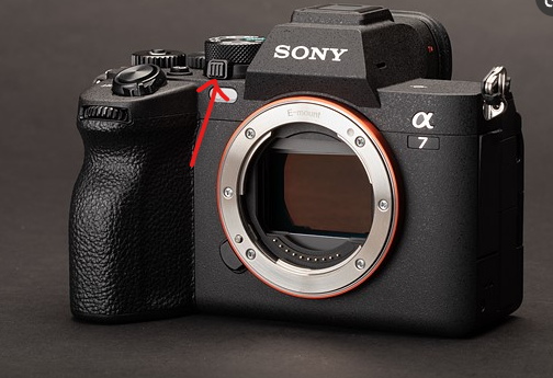

  1. I have been eagerly waiting on the announcement of Sony A7IV and quite like its features for both video and photo, I think it offers great features for both video and stills for enthusiasts and maybe semi-pros too. However my excitement got dashed quickly after watching a few videos and particularly this one where you can see the dial to switch between photo and video is under the main mode dial, does this mean you can't really use it underwater unless someone comes up with some really tricky dial to switch it? Or am I missing something here?

    I think you'll have to wait and see, Nauticam might come up with something?  Or it might be too hard, it looks like you need to grab a smooth dial with no protrusions.But if that knob up in front is what you use to turn it it looks like it requires you to press in on a button while turning which is an extra degree of difficulty.  I think you just need to wait and see.

    I was hoping that because it will have similar body to A7S III that it will be easy to fit it into an existing housing. It seems that is the case except for the dials. You are right, wait and see is the only option, however by the time a housing is ready Sony might announce a7c II by then :)

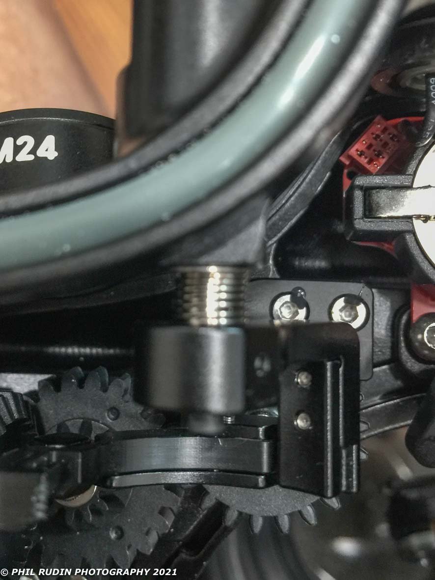

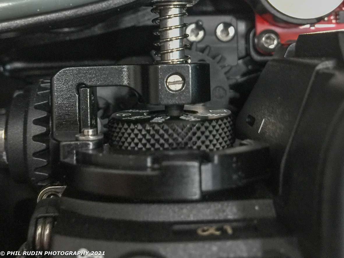

  4. The dial has a button in front you have to push in order to move it. Same as the A1 and the Nauticam housing works just fine. There is a small lever that you have to engage with that button before you close the housing.

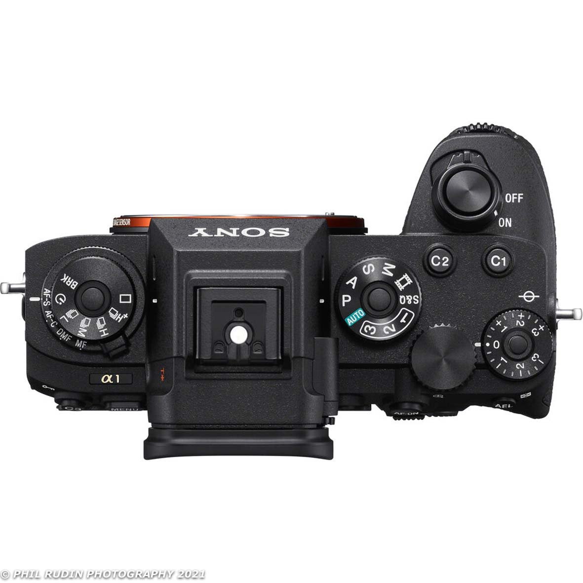

    The Sony A1 has a dual dial on the left top side of the camera which controls the frame rate (single, 10 frames, etc) with the top dial and the AF setting (AF-S, AF-C, etc) on the bottom dial. The top dial has a push button that needs to be depressed while the bottom dial has the push from the side lock like the new A7 IV. In the Nauticam NA-A1 housing the spring loaded lever that lifts above the camera when it is installed in the housing and then drops into place over both camera  dials. This control lever simply keeps both push buttons depressed and controls the focus mode while a second dial on the top back half of the housing controls the drive mode. I would expect a simpler single control like the focus lever control for the A7 IV to switch between shooting modes. Photos of the control lever below.

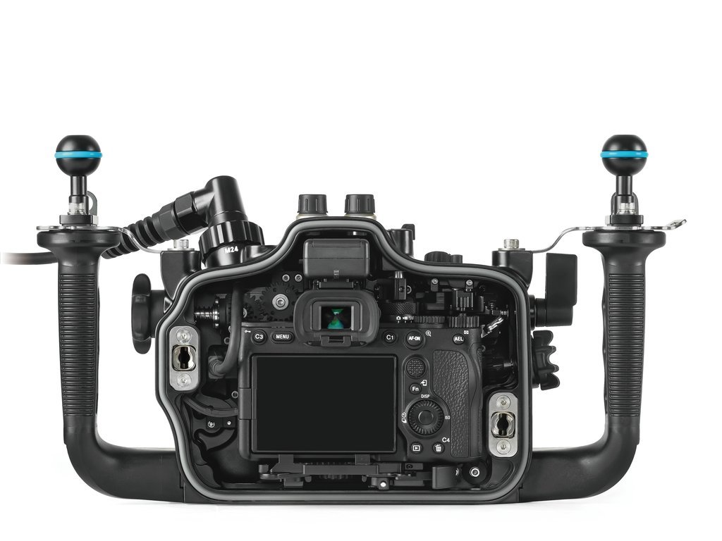

  12. The photo is for the fully developed Nauticam NA-A7IV housing for Sony A7 IV listed in the Sony housing section of the Nauticam.com web site.
    As you can see from the photo the control dial in question is fully supported along with all of the other controls.
