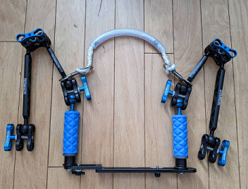

  14. I have just started using a pair of Weefine WFA37 adjustable arms. I have a total of five arms on my rig - two 8-inch ladder arms on the inner segments, the two WFA37s on the outer segments, and a generic 8-inch/60mm carbon fiber arm across the top of the housing, which serves as a base for a dive computer. Handle to arm and strobe to arm connections are with regular clamps, arm-to-arm elbow links are with long clamps. It takes a little practice to properly dial in the buoyancy, as the valve only admits water at depth, while draining the arms can only be done outside the water. The valve makes a loud squeal when water is coming in, which came as a surprise. Also, it feels weird to be rinsing the insides after a day of diving. As for strobe positioning - can't say I've had any issues.

    Sure.
    The bolt snaps on top clip onto my BCD shoulder D-rings, enabling hands-free carry of the camera through shore entries, ladder climbing, etc.
    Here it is packed into a CB70:
  17. @Barmaglot that's great, thanks so much for the photos there. It seems with the long clamps, they actually don't get in the way at all.

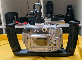

    @BarmaglotCould you by chance share what brand your triple clamp is?  I want to do something similar as your cross bar for my floats.  I am currently using my cold shoe for primary dive light.  I just realized I don't have any photos of my new setup completely built.  I'm using 4x jumbo stix floats (2x on each side) and the rig is still a little negative but I dontt always use two strobes or both arms, so the cross arm is an idea that I have been toying with.
    Also how do you like having your computer on your cross arm vs on your wrist?  are you worried about possibly losing your camera in surf or surge and also losing your computer?

    @sinetwo I'm not trying to hijack your thread I also have desire to build a tripod for my camera rig.

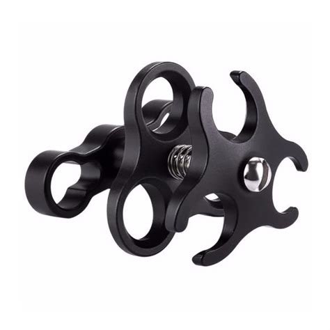

  19. Sinetwo, just one bit of a lesson I've learned the expensive way.
    There are two types of triple clamps: ones with a slot on them (see image) and ones without. I'd recommend strongly going with the slotted ones. If the clamps don't have slots, there are various positions that you cannot get the arms to move into. ULCS, for example, make both and it's clear on the illustrations which one is which.
    On mounting a dive computer above the camera, I vote for that one too. Here's my setup which, clunky though it might look, works really well.
