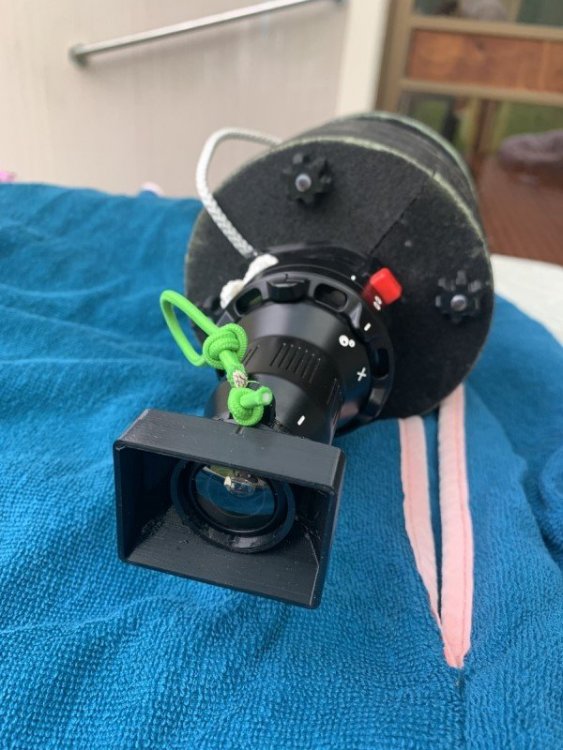

    E-Ocean offer two floats for the EMWL:
    • A +750 grams buoyancy collar, which mounts around the relay unit. The version I bought is meant to be assembled on-land (it’s a set of 6 half-cylinders), but E-Ocean are going to release an upgraded version that will make it easier to fiddle with floats underwater. The rationale being: you might find yourself limited in subject approach, due to the diameter of the whole thing. So far, I haven’t been too constrained, although for muck-dives where you crawl on sand, it can happen.
    • A +200 grams collar for the focusing unit.
    E-Ocean’s owner Lionel recommended to use the 200g piece only with the heavier 130 degrees lens (with just the 750g float, the whole assembly would be slightly negative when using the 100 degrees lens).
    I chose to use it the 100 degrees lens (the only one I have), which does make the EMWL positively buoyant (now the 100 degree piece points upwards), but once connected to my D810 housing and arms, it stands much neutral.
    • Pros: much easier to handle the EMWL underwater, less chances to let the front lens “drop” onto the bottom, a rock, etc.
    • Cons: it increases the volume of the EMWL significantly (see below photo to get a sense of how it compares with the housing size), would restrict getting into some tight spaces (hasn’t happened to me yet) and possibly makes the EMWL a bit more intrusive/intimidating for skittish critters. In practice, I haven’t noticed a difference (mind me: I dive a rebreather, so some critters just don't care about me getting close).

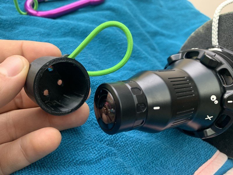

    I was nervous to loose the small rubber cap which came with the 100 degrees lens, and I needed a hood. 2 accessories there:
    • A lens cap, which comes with a bungee look (have it on your wrist, clipped on harness…), has holes to let water drain, and is actually big enough to protect the front lens without touching it: extra safety against bumps.
    • A lens hood, which can also serve as cap (though I prefer the dedicated cap when transporting the rig clipped-on): I have found the 100 degrees lens on the EMWL is very prone to flare, so I find myself attaching that hood often. Also on night dives where I need a bit more confidence against bumps, I have it on most of the time.
