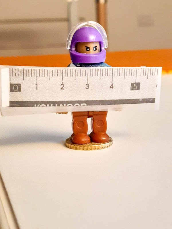

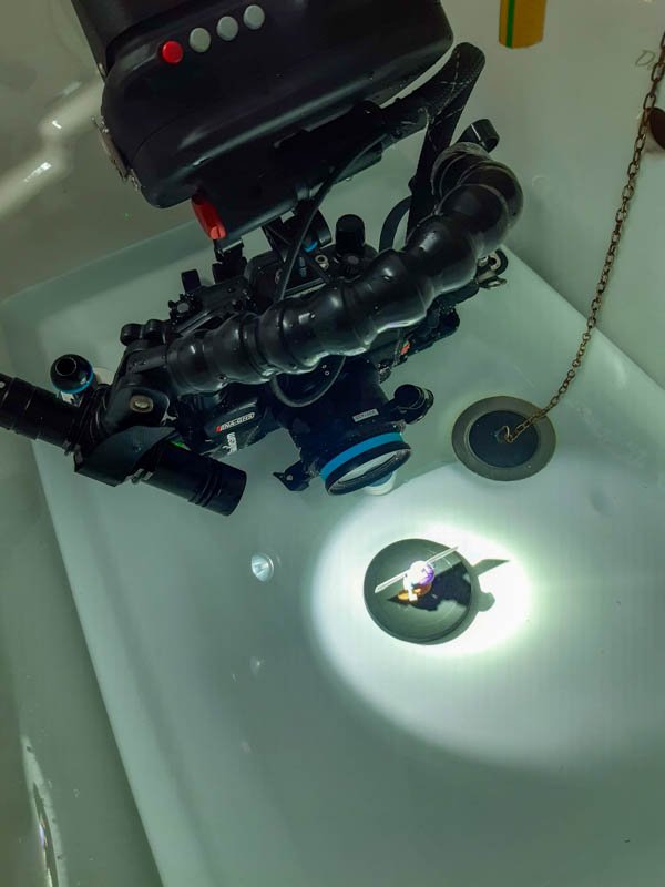

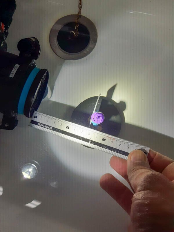

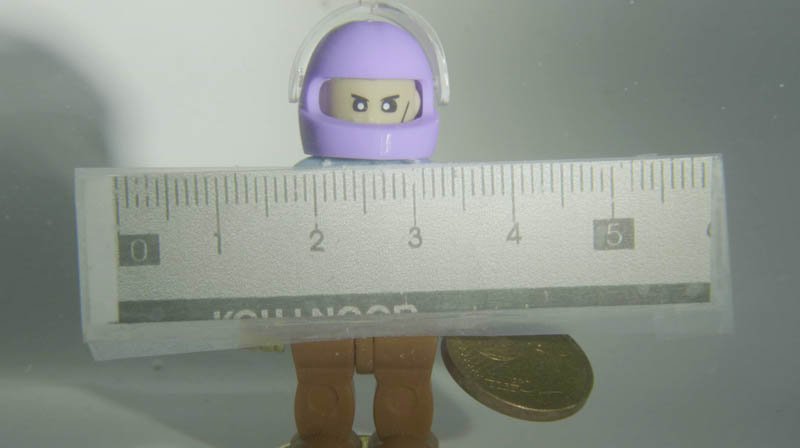

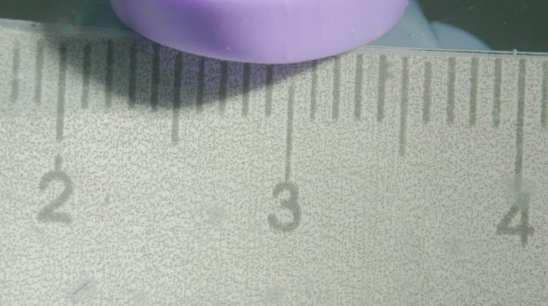

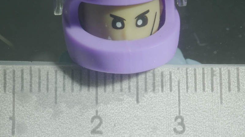

    Unfortunately we had very bad weather conditions so I arranged a test in my underwater controlled laboratories... AKA a large sink!
    I borrowed from Pietro a CMC-1 and a Subsee +5. From what I found, Nauticam was correct and I was wrong (strange :P).
    Basically I agree with Massimo, CMC-1 for video is barely usable: maybe only for corals and in perfect conditions. the Subsee +5 is a much more versatile lens especially for me as a beginner. Personally I liked the 45mm Leica better but the flexibility that the Flip system gives you in the same dive is priceless.
    These are some video frames from my test
    14-42 mm @42mm + SUBSEE +5
    Working distance: 110 - 270 mm
    110 mm
    270 mm
    14-42 mm @42mm + CMC-1
    Working distance: 50 mm - 75 mm
    50 mm
    75 mm
    Thanks to my dive buddy for enduring all that time in the cold sink water.
