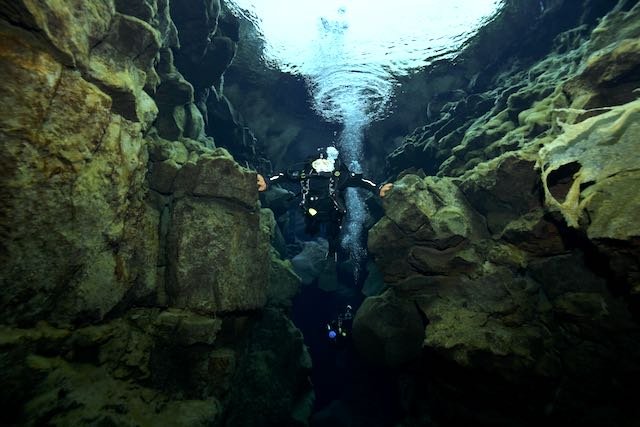

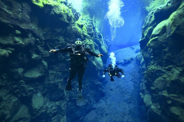

    Hi Tom it is a full frame Nikon D850 these are 2 eksamples of my wife in Silfra Iceland, it was a grey and rainy day with very poor light, so I tryed with the flash at full power, iso 400, F8, s 1/60, and the other foto is flash 1/8, iso 400, F3,2 , s 1/50
    of cause the one with F 3,2 have the worst corners but still they are not god in any of them, seen in the mirror, I shud have gone higher in iso, but on land I am not happy to go higher than 800 iso and its only one stop.

    You are attempting the near-impossible here. I am not sure even the superdome will help you. Alex Mustard has been there and has pictures of it in his book: He used the 16-35 at 16mm (which will work much better in the superdome than the 14 especially if you have the Sea and Sea correction lens (there are threads on this already on Wetpixel)) for picture #13. He shot at ISO 1000 at f/13 at 1/50s. Note much smaller aperture than what you are trying to do as well as higher ISO. Picture #96 was done with the 16mm fisheye also ISO 1000 but at f/14 at 1/80s. Again small aperture was used. To use a larger aperture one would have to go with water contact optics which are rather costly. I recall Adam mentioning in one of the videos shooting the WACP-1 at a wide aperture in a dark tunnel.

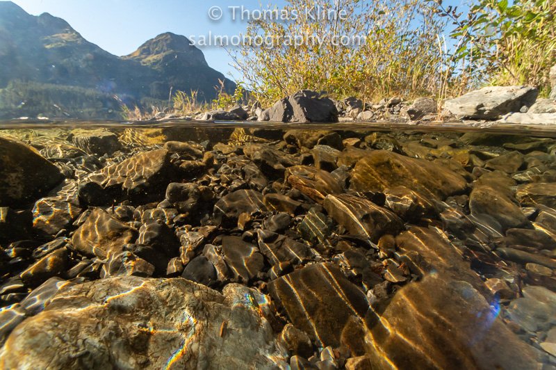

  7. Here is a shot with the 14mm at f/16 using the Superdome. Note how blurry the lower corners are. Used ISO 3600 with D4S. 1/500 to stop motion as I was wading and there were these small waves. Chris is correct, it not possible to use correction lens with 14 which is why I recommended the 16-35 zoom instead. I have used the wideport to do macro-like closeups with the 8-15. Would likely be much worse for distant subjects, need a bigger port.

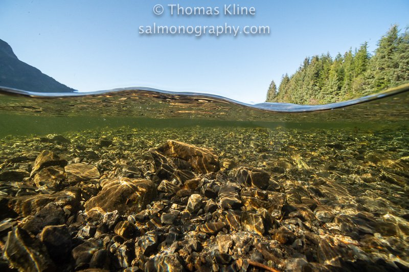

  8. Here is another shot from the same day - taken just a few minutes later. Here I am in a stream that enters the lake near to where the previous shot was taken. Trying to keep my shadow out of the picture the sun is very close to the left edge of the pic. Taken in early Sept - the sun is already low in the sky but above the mountains - now (early Dec ) it is below the mountains.
    This one at f/22, 1/500s at ISO 5600. The camera was on auto iso. Note the details on the grey rock with a spruce needle on top of it. But at the left corner it is quite blury
