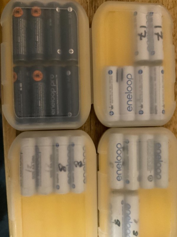

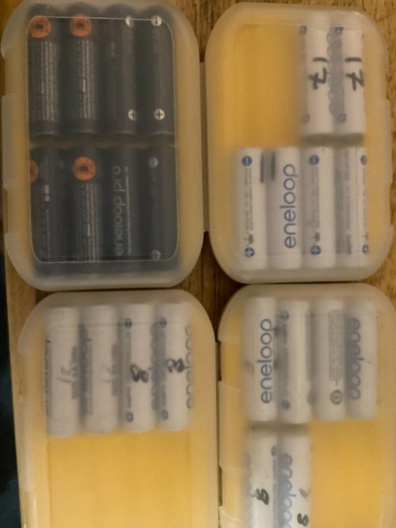

    I have found there to be a vast difference in the AAs that I use vs the Seacam battery packs. I even asked the battery expert who rebuilt mine whether Eneloops could be used as replacements but alas the sizes are a bit different. One of the big issues is the self discharge rate which is quite fast and not so for Eneloops. The ones in the Seacam packs are more like the batteries I used before switching to Eneloops in 2008. I am still using some of these. I grabbed 4 battery holders off the table next to me and took this shot - the 08 labeled ones are batteries from 2008. I only use them for lights now but I have over 10 lights that use them so I put them to good use until they die. The Seacam packs are good for about 3 years. It may be that you are getting more out of yours if you do not have interruptions  (e.g. several months) in their use. As well, mine get used in sub-freezing conditions part of their life.
