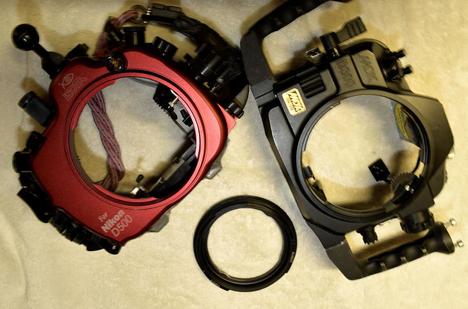

  1. The port sockets of some different makes of camera housings are identical, something I only recently noticed while working on my Sea&Sea and Isotta housings (Fig 1). When I looked up these compatible port sockets and bayonet plugs, I found that they are labelled 'B120' for the bayonet's outer diameter of 120 mm.  Items made to the B120 standard allow one to mate housings of one make with the ports of another, such that my Isotta's adapter for Subal ports fits my Sea&Sea housing.

     Sea & Sea has B120 adapters and ports with B120 fittings to mate with Isotta housings. Backscatter states: "Isotta housings use a simple port system, which is identical to Sea&Sea's method. The good news here is that Sea&Sea brand ports are fully compatible, so if you have any in your arsenal they will carry right over. You could also run a Nauticam port as long as it has a Sea & Sea style bayonet mount on it, so right out of the box you have tripled your port options." (5).

  2. Sea and sea and Isotta are 100% interchangable.  Nauticam ports you can remove the Nauticam lug ring and install a S&S lug ring.   This way the port position with respect to the lens is the same and you can use the Nauticam port chart to determine the port and extension needed for your lens.
    Some other adapters are like a small extension ring with Brand A mount on one end and brand B on the other, so they add some extension which you would need to take into account when determining what extension to choose.
    For some combinations you may find yourself lacking a zoom ring or perhaps unable to put together the correct extension for some lenses.
