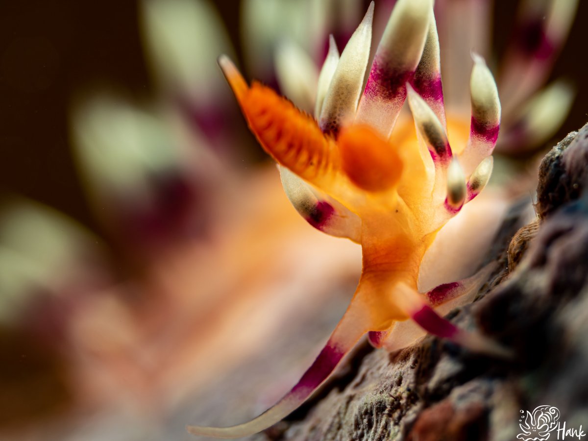

  6. I use olympus em5 mk3 Q1x2 to shoot
    Q1I highly recommend
    For your reference
    Edited by cueea1988

  8. 14 minutes ago, cueea1988 said:
    I use olympus em5 mk3 Q1x2 to shoot Q1I highly recommend
    Would you mind posting some wide-angle shots taken with them? Lighting up a two-centimeter nudibranch is one thing; doing it to a two-meter sea fan is quite another, so I'm curious as to how they would manage something like this:
