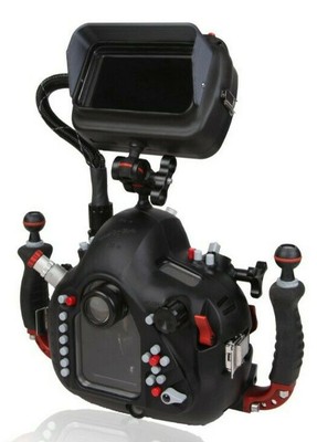

    The most important feature of an underwater videocamera is its balance and inertia in movement. These features are the norm for large videocamera housings but are complicated to achieve with photo camera housings. These have a small mass that develops vertically. If we also add a monitor on top of it we get a Cheops pyramid that is very difficult to balance.
    The photo with which Hugy advertises the monitor is worth a thousand words.
    After several tests I managed to have a perfect horizontal balance but I still have problems if I have to shoot at an angle: I have to exert a little force with my wrists on the handles because the whole tends to go back to horizontal. The force applied to the handles results in small vibrations. IBIS help me.
    All this introductory rant to say that the perfect kit for video shooting should have a development as horizontal as possible and then the monitor should be placed behind the case.

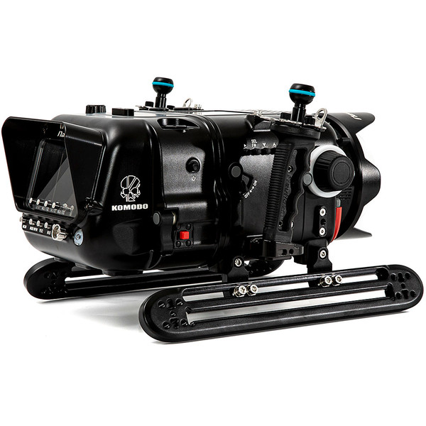

  13. Totally agree with you Davide on the frankensteinian ergonomics of DSLR-style underwater housings + a monitor on top and how impossible they are to trim in all axis. Getting the monitor behind the housing probably would help. Nauticam has some very nice designs for cinema housings with built-in monitors at the back which would be wonderful from a streamlining and trim perspective and avoid the whole external cable issue. I'll admit they're not as versatile for macro or getting the housing beneath you as a top-mounted monitor would be, but.. maybe the trade-offs are worth it?

    For cinema camera housings the external monitor position does not affect the whole system trim.
    Take a look at Roberto Rinaldi custom Seacam housing :man_in_love:
