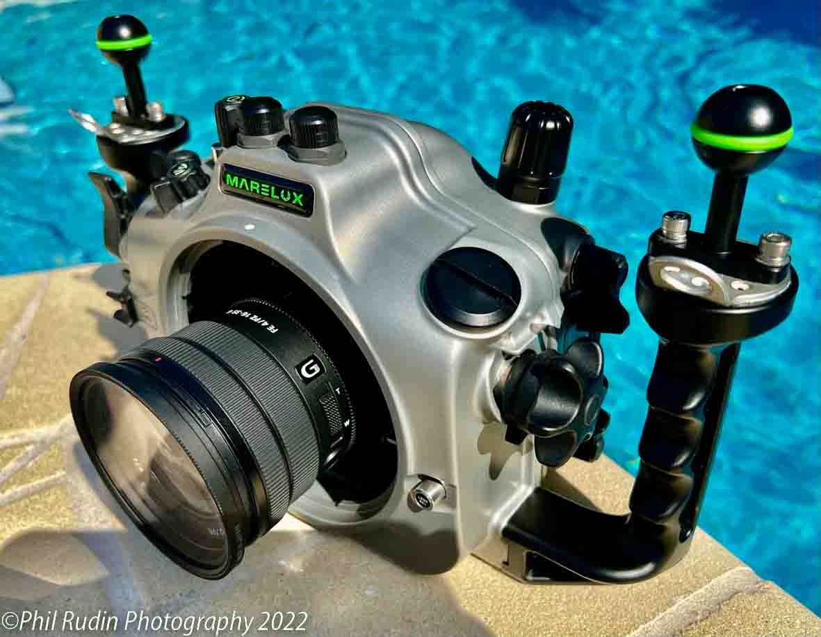

    Thanks, Phil. How did you get the correction lens to work? I thought the lens is 72mm and S&S has 77mm and 82mm.
    You use a contraption called a step-up ring adapter (allows you to use 72mm threaded filters on a 77mm threaded lens)
    (Sorry, i really wanted to use that word :lol2:)
    Ah. I thought that given it moves the converter further from the lens that it would defeat the full purpose of the correction lens. If that is not the case, then great!
  12. This is how the Sea & Sea converter looks on the 16-35mm F/4 PZ lens.
