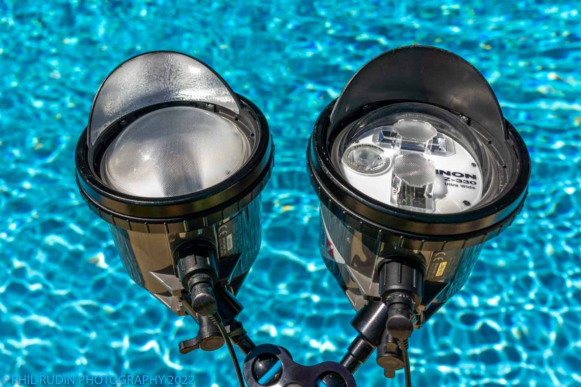

  6. I would add for those considering buying these strobes new that the current Z-330 type II has two upgrades. first the Fly-eye coating which only covers the flash tubes on the Z-330 now covers the entire dome on type II creating a much softer light over the entire coverage area and eliminates some of the need for defusers while retaining the full power output. Second the Z-330 shade is black and does not reflect light well while the type-II model has a reflective coating.

  9. I remove mine after beach dives because of sand and put a very small amount of lube on the threads. Salt water is also a bit of a problem. This is not even a small issue because if you are cleaning equipment after diving the salt dissolve. The new Z-330 type II strobes are the same $650.00US as original model.   I have had two Inon Z-330's since late 2017 and have traveled the world with them. I have never had a problem with the strobes or any of the accessories.
    Photo with the new type II on the left and the original on the right.

  12. I believe Wolfgang was asking if the use of the shade (the new one, with internal reflection) does change the quality of the light of the strobe (for instance if it makes the light area uneven)

  15. If I am understanding your question, the shade reflects light but it will not increase the intensity of the light. So I have not had any images that have hot spots in the frame as a result of the light being redirected back into the frame.
