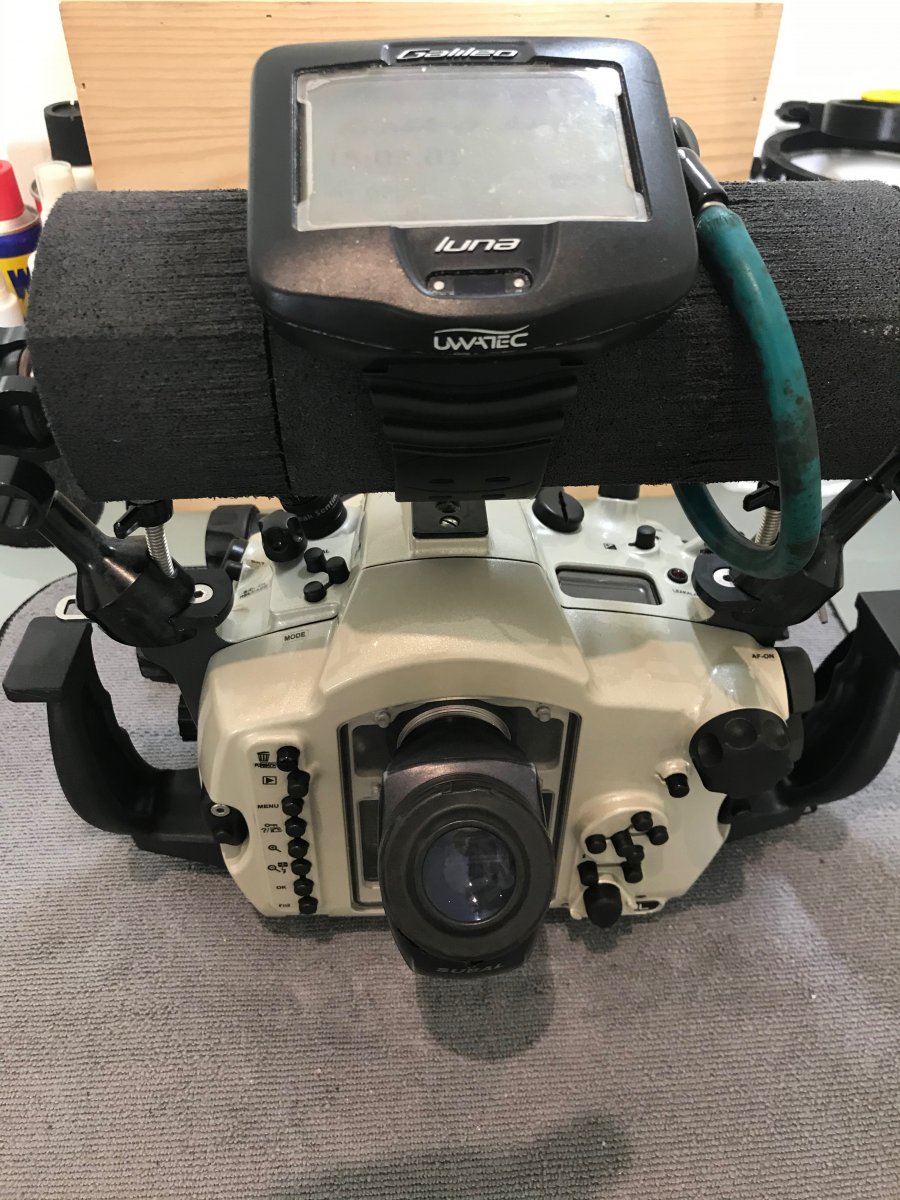

  6.
    Here's a pic of how mine is setup. It's not as clunky or bulky as this pic suggests.

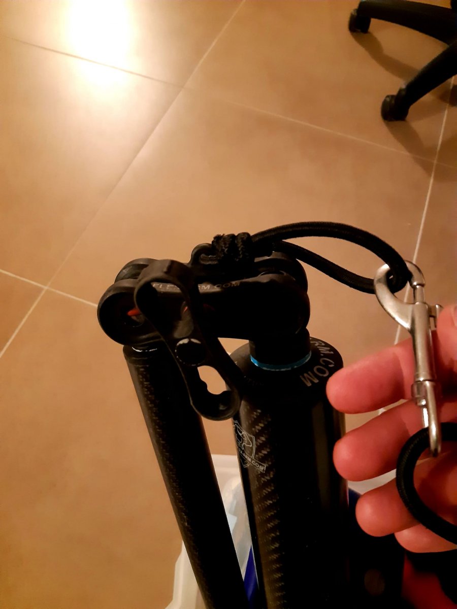

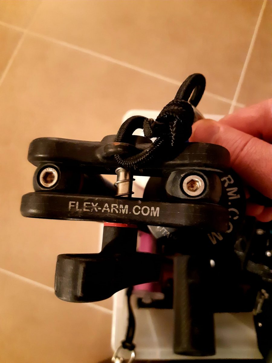

  8. Hi Owen,
    Give a look at this Italian company:
    https://www.flex-arm.com/en/carbon-fiber-arms/carbon-fiber-float-arms
    I have been using several of theirs arms and clamps for years now and they are really well made and don't break the bank.
    I am struggling to find many reviews on these. I’ve seen the type of diving you do, so I imagine they are fairly robust. Have you successfully had them at 100m?
    How do you find the clamps? I see they are ‘polymer’ (plastic). Have you had any trouble getting them tight with heavy lights? Do they bend at all?
  9. I've been using them for 4 years with several dives > 120 m. Everything perfect. I like that you can even remove the ball if needed.
    For the clamps I don't have an extensive use because I have only a couple of them (the long one) to join arms segment in the middle. For now (1 year) no sign of bending.
