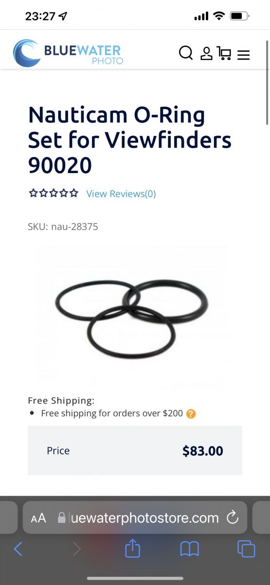

  1. I would like to have a spare set of o-rings for my Nauticam 45-degree viewfinder. Apparently Nauticam would like me to pay $83 for this privilege.
    Have any of you come up with hardware store alternatives?
