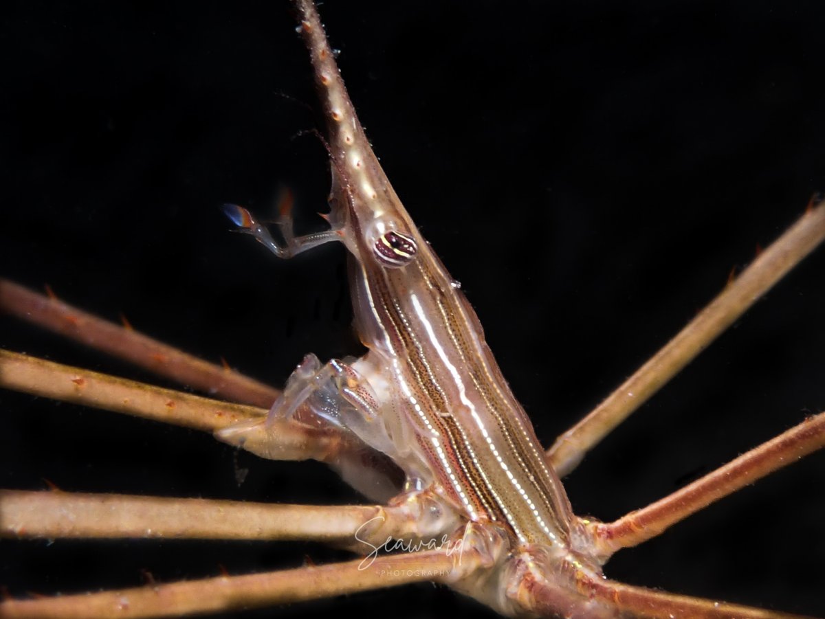

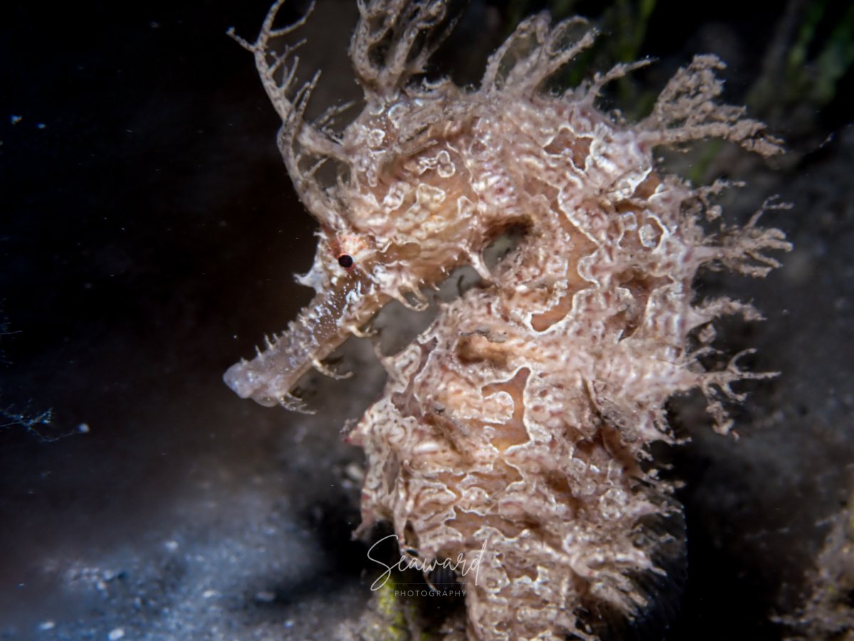

  4. hey thanks to both of you for the input on this. part of the issue is figuring out where the light 'kisses' the subject  and being able to mess with it a lot without my subject running away lol. i will keep messing with it! i've got a few more dives this week so we'll see if i can master this.. so far these two are probably the best of the first couple of dives with the strobe.
  5. Looking pretty decent in those shots, just need to keep practising.
    Agreed! They are not too shabby!
