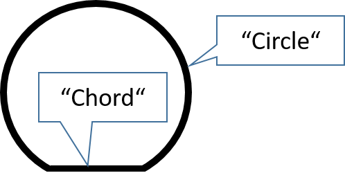

    Thanks for the reply - not sure what you mean by chord ? What’s the German word for it ? Thanks.
    chord means "Kreissehne": The diameter of the put-through part of the viewfinder is not a perfect circle, but is a circle that has been cut by a chord (it matters only in the last 1-2mm):
    The flat "chord" of both viewfinder and opening need to be aligned at the last 1-2mm to give a perfect fitting and make placement of the O-ring possible...
    Wolfgang
    Edited by Architeuthis
    Wolfgang
    Hi Wolfgang, I think that is for the Mirrorless (33205) version of the viewfinder.  The DSLR version uses two pins to prevent rotation.
  10. chord means "Kreissehne": The diameter of the put-through part of the viewfinder is not a perfect circle, but is a circle that has been cut by a chord (it matters only in the last 1-2mm):
    Wolfgang
    Thanks for then example - mine is perfectly round so unfortunately no luck
