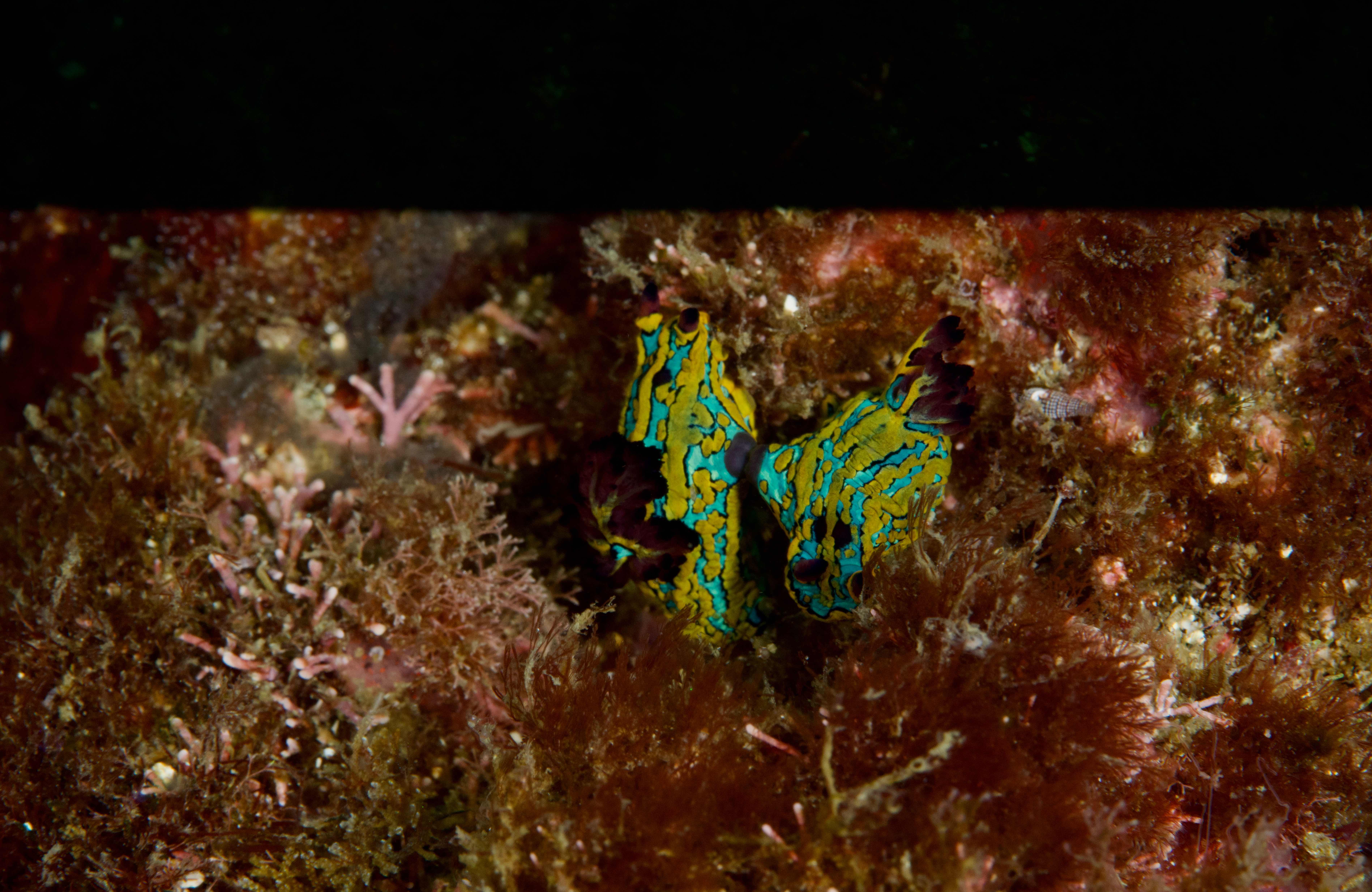

    Hello friends
    I sometimes have this issue where the upper part of the image is dark. What could this be ? It’s always a straight dark area so not sure ?
    Only happens underwater in the housing.
  2. Shutter Speed too fast?
    Inviato dal mio CPH2005 utilizzando Tapatalk
  3. That's my guess as well. I think sync speed on your Sony is 1/250th... with faster and faster shutter speeds the black band gets bigger and bigger.
  4. That's my guess as well. I think sync speed on your Sony is 1/250th... with faster and faster shutter speeds the black band gets bigger and bigger.
    Thanks this is shot at 1/320 - will try to limit below 200 to be safe .
  5. Strobe sync speed for Sony cameras (with the exception of A1) is 1/160s. If you use a TTL-capable trigger, such as the one from UW-Technics, it provides more accurate timings and full-frame cameras (A7, A9) can go to 1/250s.
    Edit: This is referring to interchangeable-lens cameras. Compacts (RX10, RX100) have leaf shutters that can sync all the way to 1/2000s.
    Edited by Barmaglot
  6. I have a Sony A7 RIII, fastest sync speed is 1/250 with a Sony flash or external TTL such as Ikelite.
    The 1/160 is correct for older cameras (such as my old A65)
    It depends on what is triggering it, the trigger needs to fool the camera into thinking there's a Sony flash attached.  If it's a manual trigger it needs to get the timing right to achieve 1/250.
    Best thing to do is take a few test shots to see what minimum speed you need.
  8. are you otherwise happy with the Z330s?? hope this helps get you sorted out!
  9. are you otherwise happy with the Z330s?? hope this helps get you sorted out!
    Yes it is sorted ! The 330s are good otherwise - I do mostly macro so they are more than plenty
