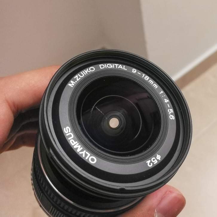

    I found a copy of the lens for $260. It has a small scratch on the front element. I'm trying to get photos of the scratch.

  5. The attached photos show the scratch on the front element as well as images captured with the scratched element.  I can not see anything in the photos Would you guys mind taking a look to see if you see anything?
    @ChrisRoss mentioned that the min focus distance is not too close (0.25m) so maybe the lens cant see the scratch.
    Edited by Dann-Oh
  6. It may not show up in this type of shot as the scratch won't be in focus and the sun would need to be in the right spot in the frame for it to be seen.  It would be seen as a soft area in the frame and you might see that on a shot of a continuous pattern with some good contrast.
  7. Good point. I was actually able to find a different copy of the lens with perfect glass for only $20 more.
