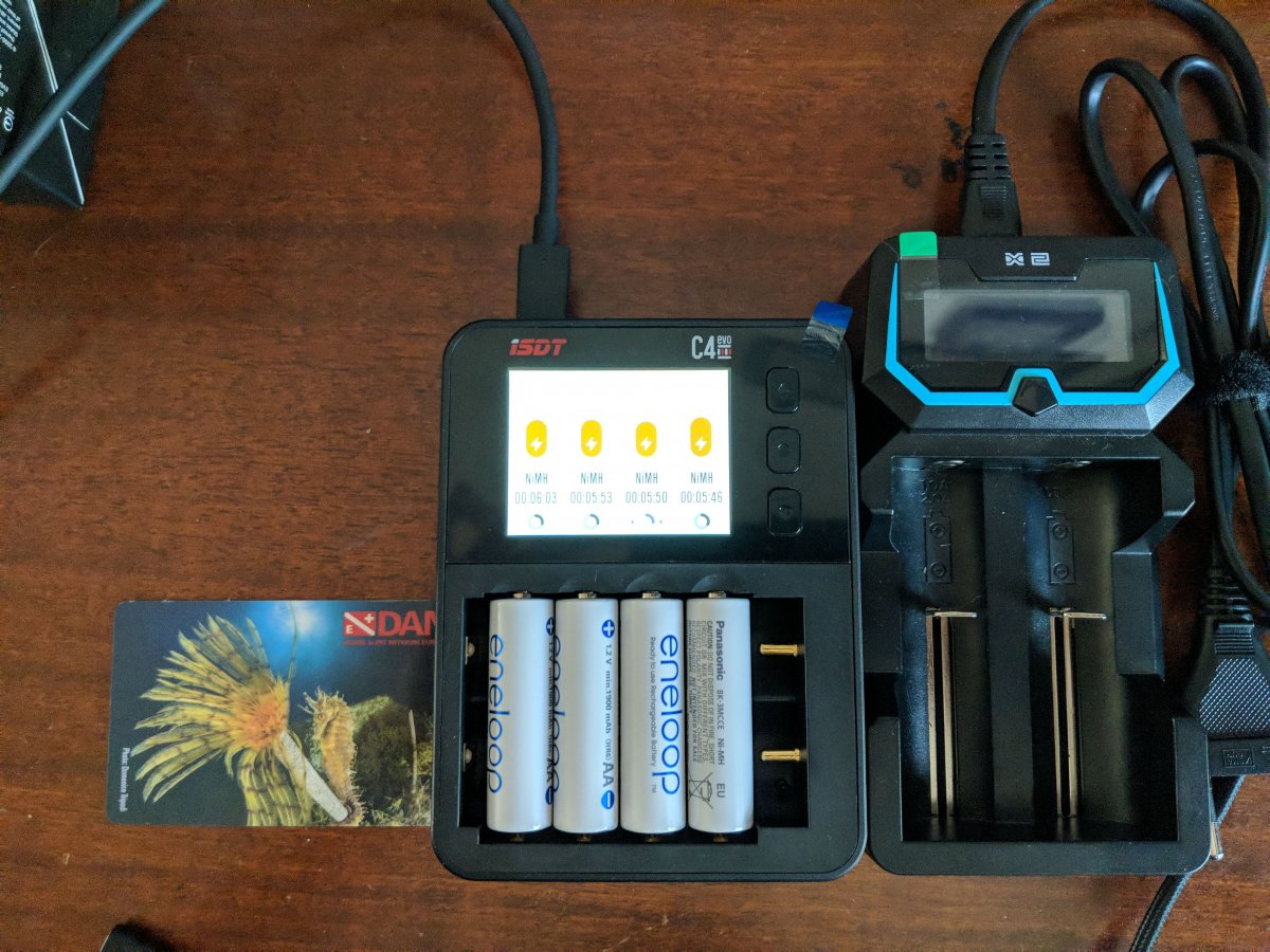

  13. C4 Evo has arrived...Below pic next to Xtar X2 charger (cant compare to VC4S as i am not home-home at the moment) and credit card sized DAN thingie. Display was on high brightness hence camera did not capture the battery outlines etc, only the brightest elements. Ran 4 Eneloops at 1A each, went pretty well though temp range on batteries was 43-46 degrees, so a bit toasty.
    Charger is pretty small, in fact so small i am now tempted to order the N8 after all, since it is only 1/3 or so longer :D
    Edited by makar0n

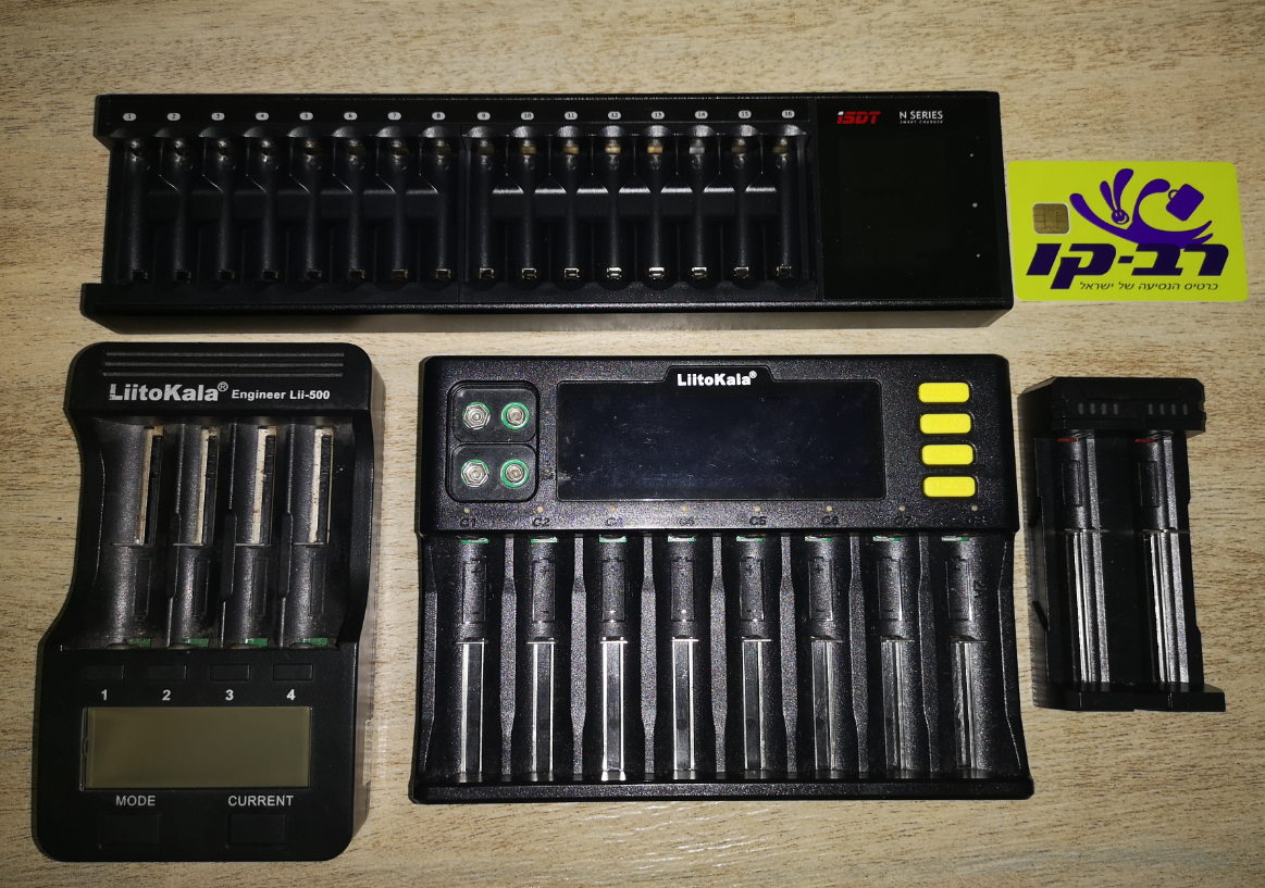

  14. Got my ISDT N16. Here it is next to a Liitokala Lii-S8, Lii-500, XTAR FC2 and a credit card:
    The casing is metal, so it should be pretty good at dissipating heat, but it still gets plenty warm when operating. There is a USB-C port, but it can't draw power from it - I'm guessing it's only used for software updates and the like. A shame, since I have several high-powered (65-100W) USB chargers that could save me another wall wart in my luggage.
    It has change/discharge/reactivate/analyze functions, but the setting is global for all sixteen bays at a time. Current draw can be set from 0.1A to 1.5A in 0.1A increments, which is also global. Total power draw can be capped, with 36W being the maximum setting. However, when charging sixteen cells at maximum rate (1.5A setting) reported current draw was 0.9A~1.1A per cell (it varied between batteries). I also had several cells that the Lii-500 refused to charge or test, showing weird voltage readings (1.8V in some cases, over 4V in others), and the N16 managed them without issues.
    Since I'm carrying 40x AA, 2x 26650, 2x21700 and a few 18650s (unless I'm planning to shoot fluorescence, in which case I need more 18650s), I think I can make do with just the N16 and FC2 in my dive photo kit bag.
